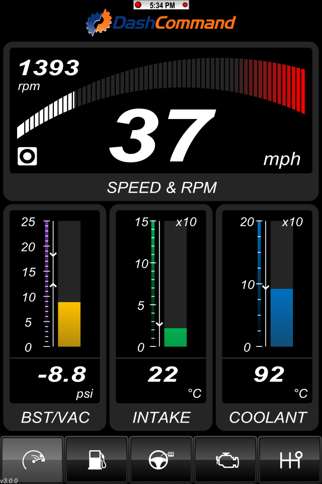

Dash command is an app you use with a obd2 elm327 device that reads your cars status and gives you live readouts as you drive and it says the coolant temp is 92 when driving maybe this is the engine temp?

I had a feeling it was an app, and yes, that is coolant temp. Now you just need to get the level sensor and loss of coolant sorted out.

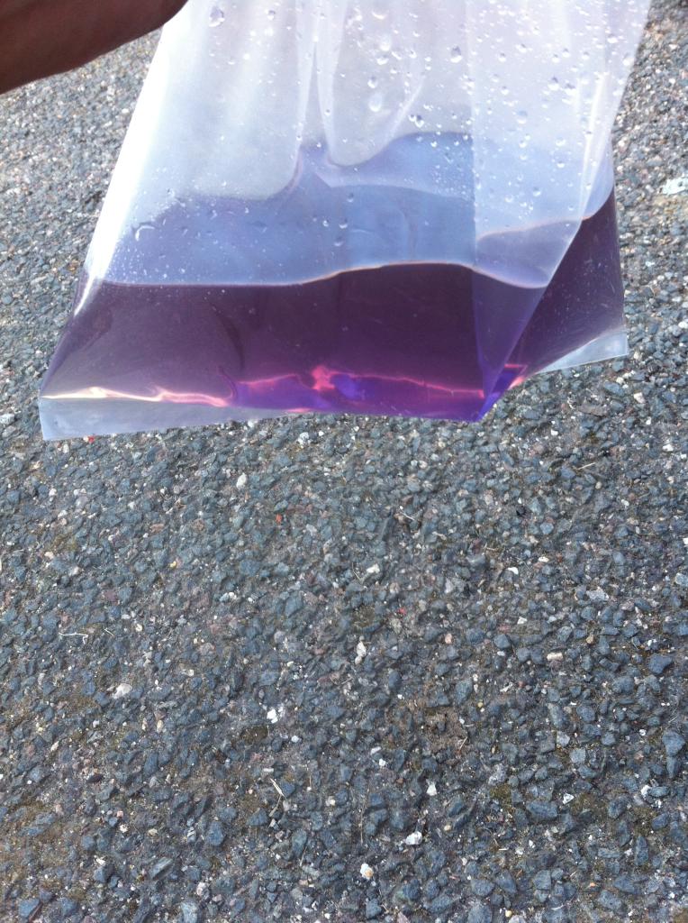

I thought the coolant in our cars was meant to be orange not purple?
What do i use when i change the coolant now?

It should be orange (see notice on your expansion tank cap). Your owner's manual will have the specs. A copy is in the DIY sticky on the main forum page if you don't have one.
If you drain and flush the system, it won't matter what's in there now and at least you'll know it's all good. I would find the leak first to save doing it again.
Until you do, a little more distilled water won't hurt to keep it full.
p.s. I use Prestone DexCool (used by GM)
Old Sep 27, 2014 | 11:01 AM
DaveInVA's Avatar
Joined: Jul 2014
Posts: 812
Likes: 268
From: Damnville, Virginia
That odd color may be the result of a previous owner mixing 2 types of coolant not knowing they shouldn't be combined.
