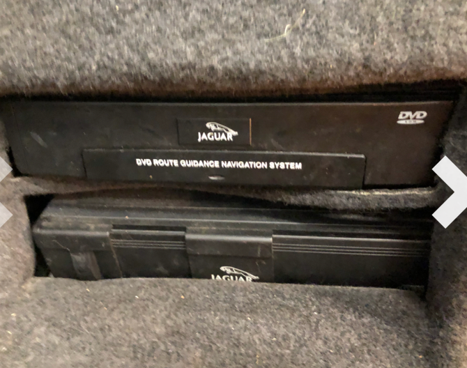

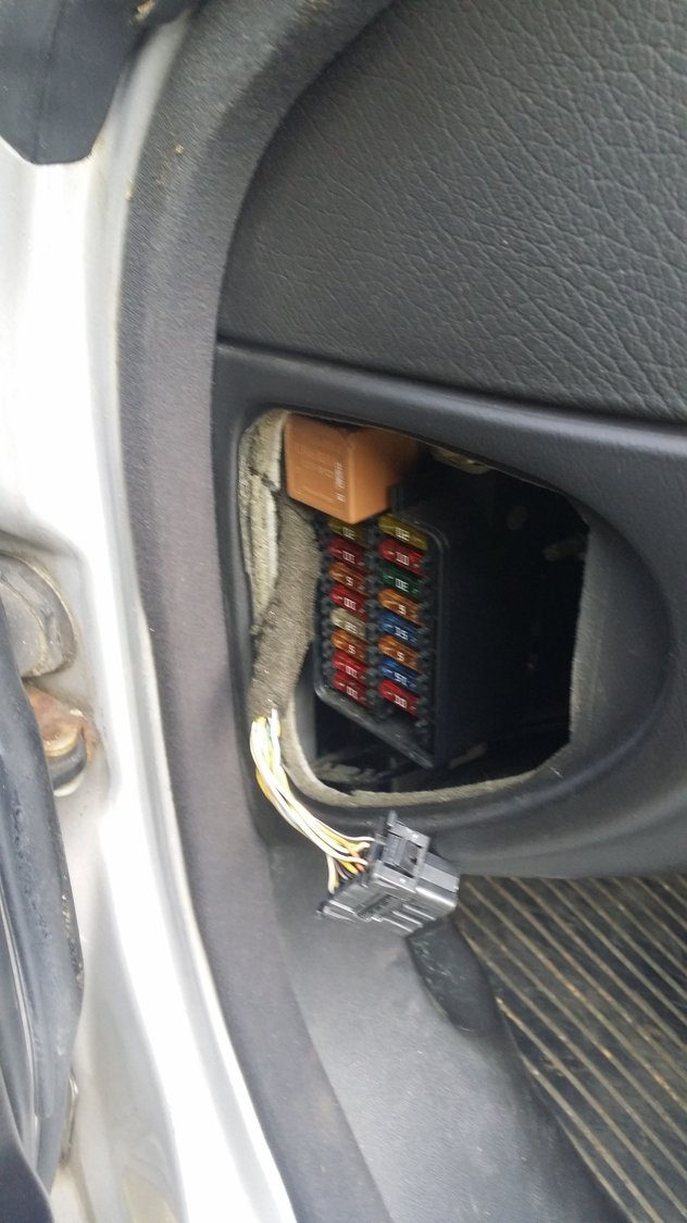

Just purchased a 2003 XKR convertible. No power to the above components. Is there a common fuse? The previous owner I'm told disconnected the navigation and amplifier in the trunk to solve battery drain. I reattached those plugs, but still no powe and can't find which fuse this would be! Also found this plug in left front interior. What is it?

Park this: you need to get a handle on why he disconndisconnected the amp / navigation. I've seen 1 example of a bad transistor inside amp keeping the amp on 7x24. My point is: while its rare event, it will drain your battery quickly if defective.

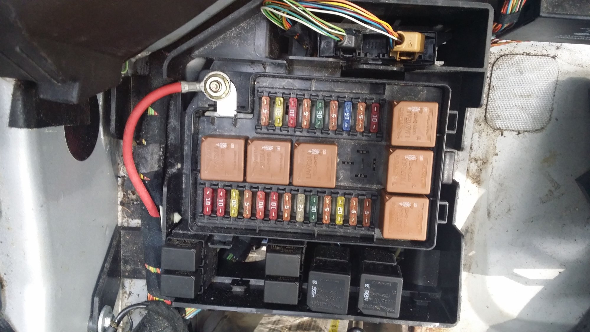

Spoke to the previous owner today. He said he disconnected the amplifier connection in trunk, and pulled the fuses on right side interior for both. He couldn't remember which fuses they are, but I'll look tomorrow. The 2 fuses have to be the reason for no power to radio and navigation.
