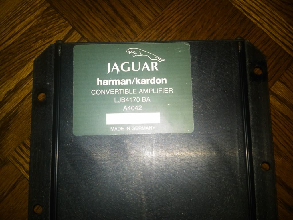

Well....I got the Amp removed. See photo Same part number as Kevins.

And the saga continues.....I did receive the Amp from KevinW, plugged it in...but still no sound!. DARN! So....would that pretty much indicate the Radio unit itself is the problem? Other than the wiring harness, not sure if there is any other component left to check/test/replace. Given the failure mode....a wiring issue seems highly unlikely. I'm open to any suggestions from the group and also would ask if anyone might have the radio itself (AM/FM/Phone/Cassette/CD) and willing to sell it.
