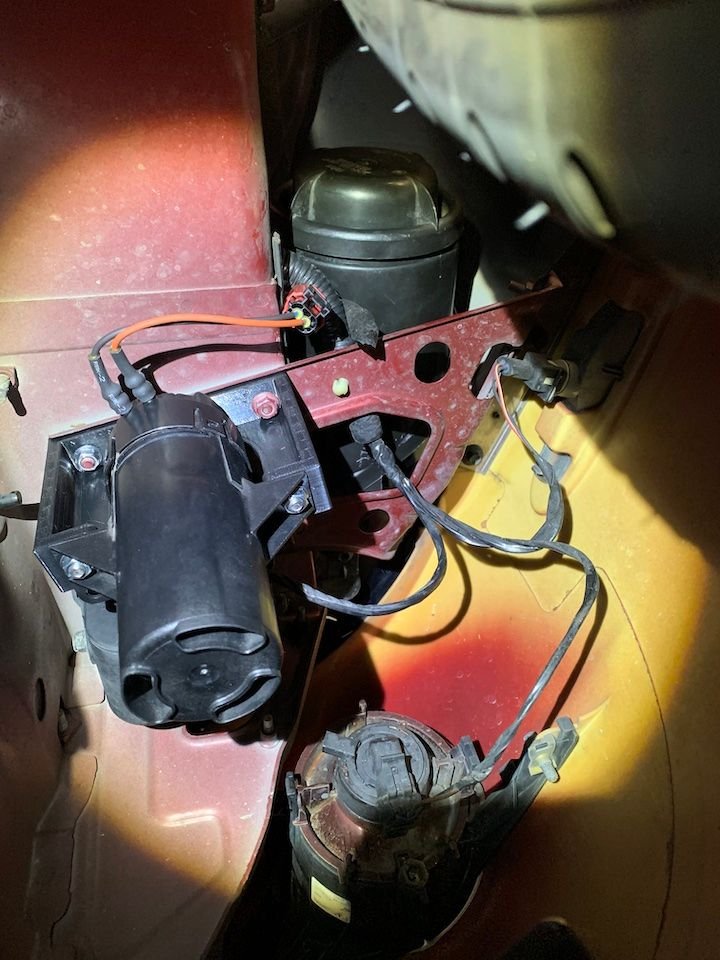

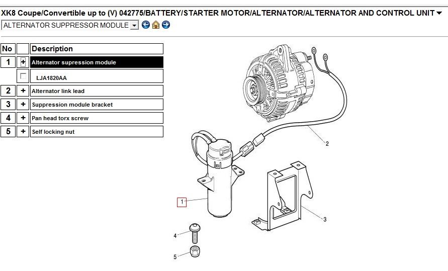

I've had a perfectly minor issue with alternator noise in the bluetooth addon from discount car stereo that only bothers me, not my wife, on my wife's car. Since I've been driving it more, I decided to put on the noise suppression module that I've had for quite a while. Unfortunately, there are no more brackets to be had, it appears (see below), so I made my own (see below). I didn't know exactly where it should be located since I've never seen one installed in an 01 or 02 car (in the engine compartment for earlier, supposedly behind the right headlamp in my MY). So, I put it behind the headlamp on convenient screws (see below).

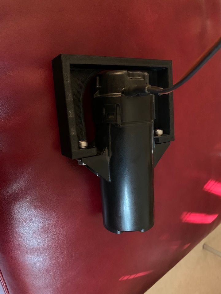

I 3D printed it in black polycarbonate, should be good to engine temperatures. PM me for *.stl for anyone else who wants to print one.
Number 3 is unavailable. So...
... I designed and printed a new one...
... that I installed here, behind/under the right headlamp.

For me, it was coming through system power, not radiated, not antenna, not grounds. With an external regulated supply, was completely quiet. With giant capacitor in the noise suppressor (22,000 uF) across the alternator, now quiet.
