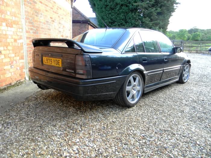

p.s. and if you like the Jag, you'll love the other car I have to bring in from the UK...:-
