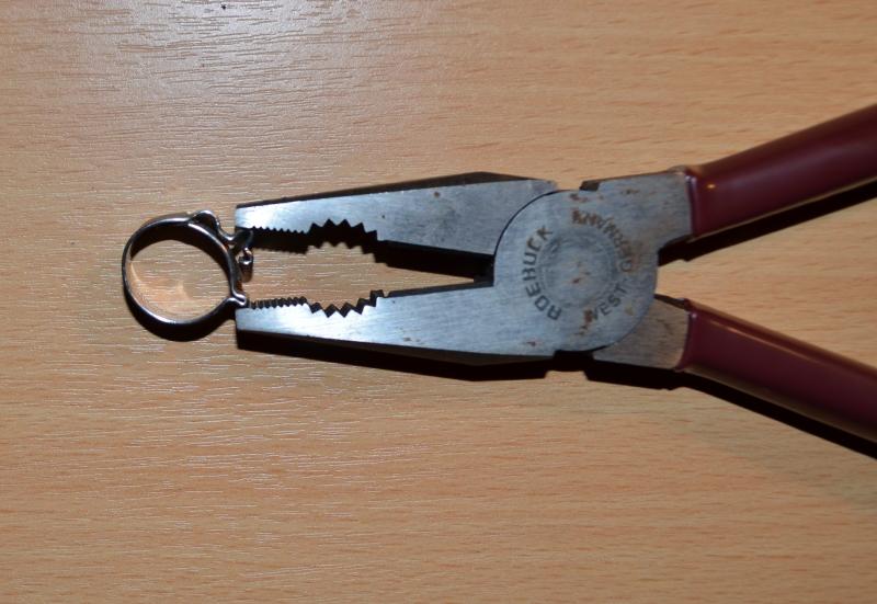

Here's a view of one open on the left and one closed on the right. Makes it a little easier to see how they work:
This is one of the Expansion Tank hoses I expect you want to remove?
As WhiteXKY says, easy to open and close with ordinary pliers.

Yes, conventional pliers. If they do not instantly pop open when you squeeze the outer ears, you can lever it very gently while squeezing the outer ears with a small screwdriver in the rectangular window. Do not force it or you can deform the clamp with the screwdriver.

+1
Squeeze outer ears together to open:
and inner ears together:
to close:
Very little pressure required.
