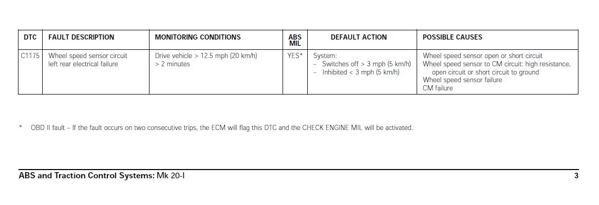

Until you rectify the issue with the the left rear Wheel Speed Sensor, the C1175 will persist.
As long as that code is stored, the CEL will stay illuminated.

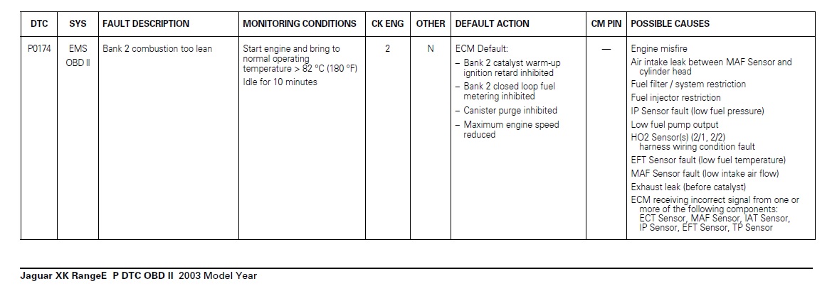

I just recently had the P0174 code on my 2003 XK8. I cleared the code and it has been a couple of days. The code has not reemerged as of yet, but could you give me some direction of what you did and tell me what to look for. I thank you in advance.
Old May 3, 2013 | 01:55 PM
Here's the list of possible causes for code P0174 from the Jaguar DTC table for your MY:
It can sometimes just be an out-of-range signal from one of the sensors to the ECM so it may not come back.
