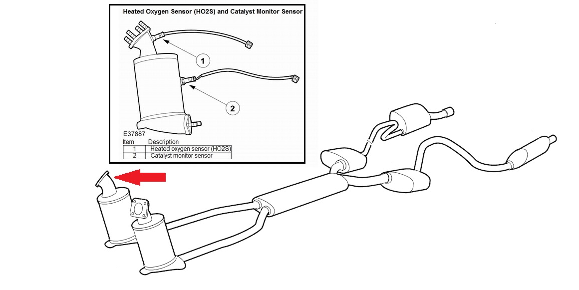

I'll leave it to US members to suggest the best sources for replacement sensors but can show you where they are (arrowed in red with detail in the box):
