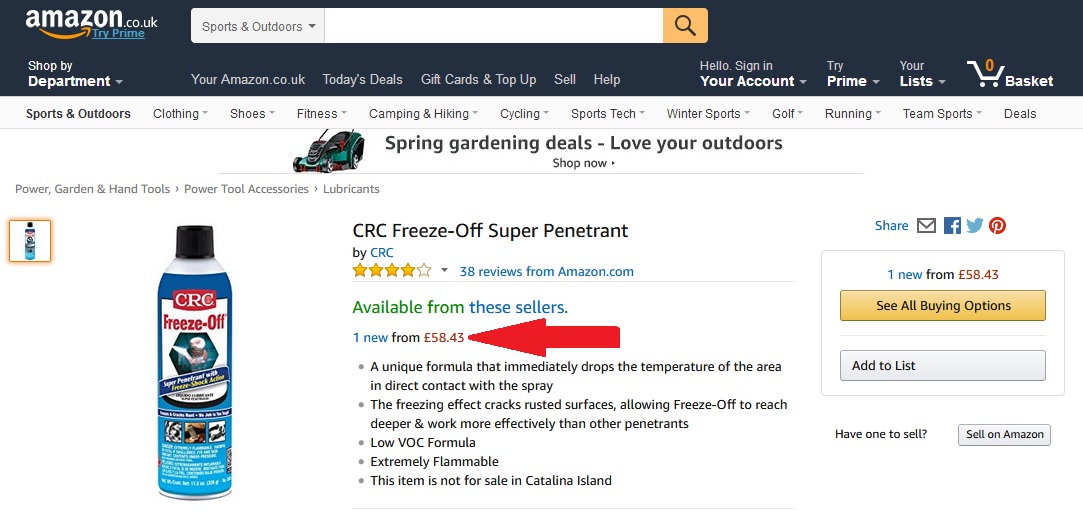

For members on the right hand side of the Atlantic, CRC Freeze-Off is also available from Amazon UK .....
58.43 UKP = $82.52
Another US product we can't get our hands on over here without a second mortgage. I've been trying to find KANO Kroil at less than the cost of a new front upper wishbone for years.
58.43 UKP = $82.52
