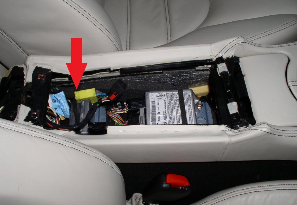

There's two yellow connectors under the Centre Console. The telephone connector is the one closest to the ashtray. This is my 2005 XK8 fitted with OE Jaguar Bluetooth (telephone connector arrowed in red):
I can't see anything plugged into your yellow telephone socket which suggests your vehicle is not fitted with OE Bluetooth.

Right! I cannot believe I missed the fact that the front yellow connector has nothing connected to it! D'OH! Probably some odd mind thing since the wires come out towards the front.
