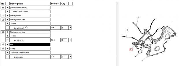

Looks like it is a two piece gasket, plus two o-rings:
(Assuming last 6 digits of your VIN are under 042775)

WhiteXKR, in your first post, is that the timing chain gasket I seek?
Old Jun 22, 2011 | 08:12 PM
WhiteXKR's Avatar
Joined: Apr 2010
Posts: 7,657
Likes: 3,020
From: Arlington VA USA
Yes, but they are crossed into these new numbers now (pricing from Gaudin Jaguar website):
AJ83699 $19.50
Engine - Camshaft & timing - Front cover gasket
Front cover gasket, innner, all models - 4.0l, 8 cylinder 1997 - 2003
AJ83700 $42.75
Front cover gasket, outer, all models - 4.0l, 8 cylinder 1997 - 2003
KSC145624 $0.76
Engine - Camshaft & timing - O-ring
O-ring, xj, xk, sedan - 4.0l, 8 cylinder 1998 - 2003
