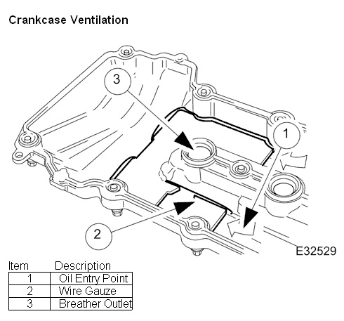

So here's my issue: When reviewing JTIS (and several other technical write-ups from Jaguar on the AJ26 engine), they mention and show several times that OIL SEPARATORS are installed in both valve covers, below the orifices for the Full-load and Part-load Breather tubes. Quoting JTIS, "each camshaft cover oil separator consists of wire gauze packed into an open ended enclosure in the top of the cover, below the breather outlet."
The intent of these separators is evidently to allow the passing of normal air flow through the crankcase (along with normal blow-by), without oil getting up into the Full-load and Part-load Breather tubes.
I've attached an image from JTIS that shows one of these oil separators in place. When one pulls off the Full-load Breather tube on the right-hand valve cover (the tube that also connects to the the air intake system...one should see a metal plate or wire gauze...that's the oil separator, and it's preventing oil from splashing up into your tube.
I DON'T HAVE OIL SEPARATORS in my valve covers. When I look down into my Full-load Breather orifice, I see camshafts. So evidently, perhaps with higher revs and normal blow-by, a bit of oil is splashing into my Full-load Breather tube and then dripping down into my intake system.

The oil separators were in place at the time the valve covers were off to do the tensioner replacement. - 2001 XJR.
It's like a stainless steel pot scrubber sandwiched between a plate and the valve cover under the breather openings. The plate is say ... 5 inches square or so.

I got a look at an old valve cover from an AJ26, and it's got the oil separator in place below the full-load breather opening.
Don't know what happened to mine...either it didn't come with one (my XK8 is VERY early), or some tech removed it at some point. In any case, I'll definitely be taking care of that problem soon.
I don't imagine it would be a good idea to try and fit an oil separator to my existing valve cover...probably should get another one that already has the oil separator in place.

I had my valve covers off during my timing gear change, and the L/H side breather plastic outlet was damaged. I removed the cover on the breather, removed the breather metal mesh, cleaned the area, machined a new outlet from brass to match the original fitting, drilled out the old fitting, and epoxied the new one in place. I just clipped the breather hose on it and it fits fine.
The breather cover can be removed from inside the valve cover by VERY CAREFULLY bending the tangs on the metal plate, and then removing it. The pads will then just fall out. Straighten the tangs on the cover plate, again VERY GENTLY, and they are ready to reinstall. When they put the pads in originally, they just layed the pads in the cavities, layed the cover plate in position, and then pushed the cover plate down. Just doing this, bends the tangs and locks the cover in position. So it is not a big deal to take them on and off.
You might want to look on the inside of your valve covers and see if the plastic molded area is present. If it is, then they must have forgotten to put in your pads and covers. See if you can order the parts. If the covers are off, it is only a 1 minute job to install them.

I popped off my original right-side cam cover to see if it has the pegs in place for fitting an oil separator...it does not. Strange.
So, I've ordered a new cam cover from Gaudin, $ 183, and they have confirmed that the new cover has an oil separator in place under the full-load breather orifice. Once I've got it installed and I (hopefully) notice that much less oil is making it into my intake, I'll post some kind of informative thread, with pics.
