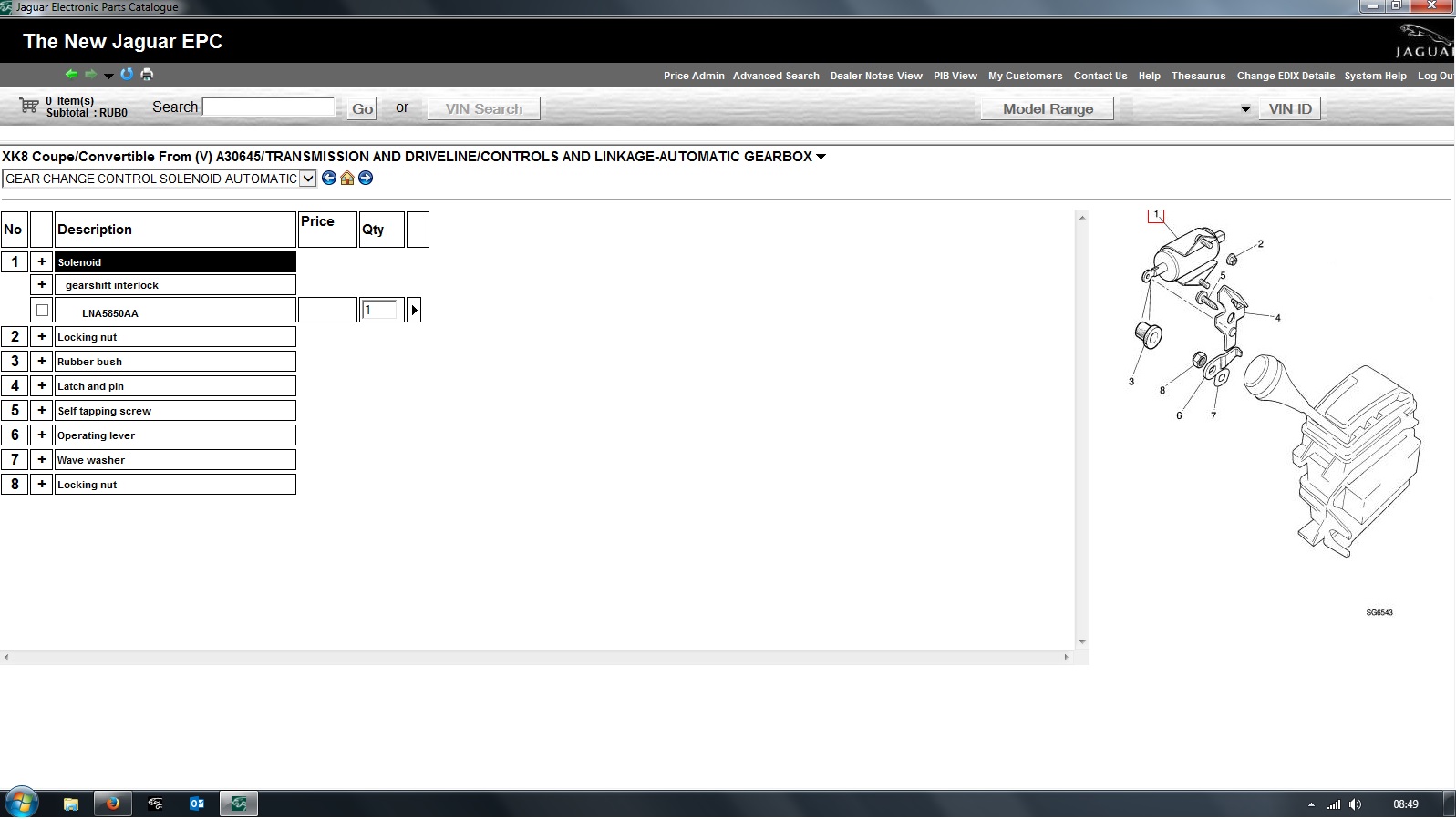

probably the battery, yes. If it happens again, jiggle the gear shifter and try again. There is a history of the switch on the tranny not having a great connection telling the computer it is in P or D. I can't remember the name of the switch.
Old Aug 6, 2014 | 02:59 AM
+1
Of course, I'd have to guess which MY you have because the info isn't in your Signature!
Battery is my first preference for the culprit. The transmission switch Matt mentions as another regular cause of this issue is the Gearshift Interlock Solenoid (item 1):
This is for the 2003MY.

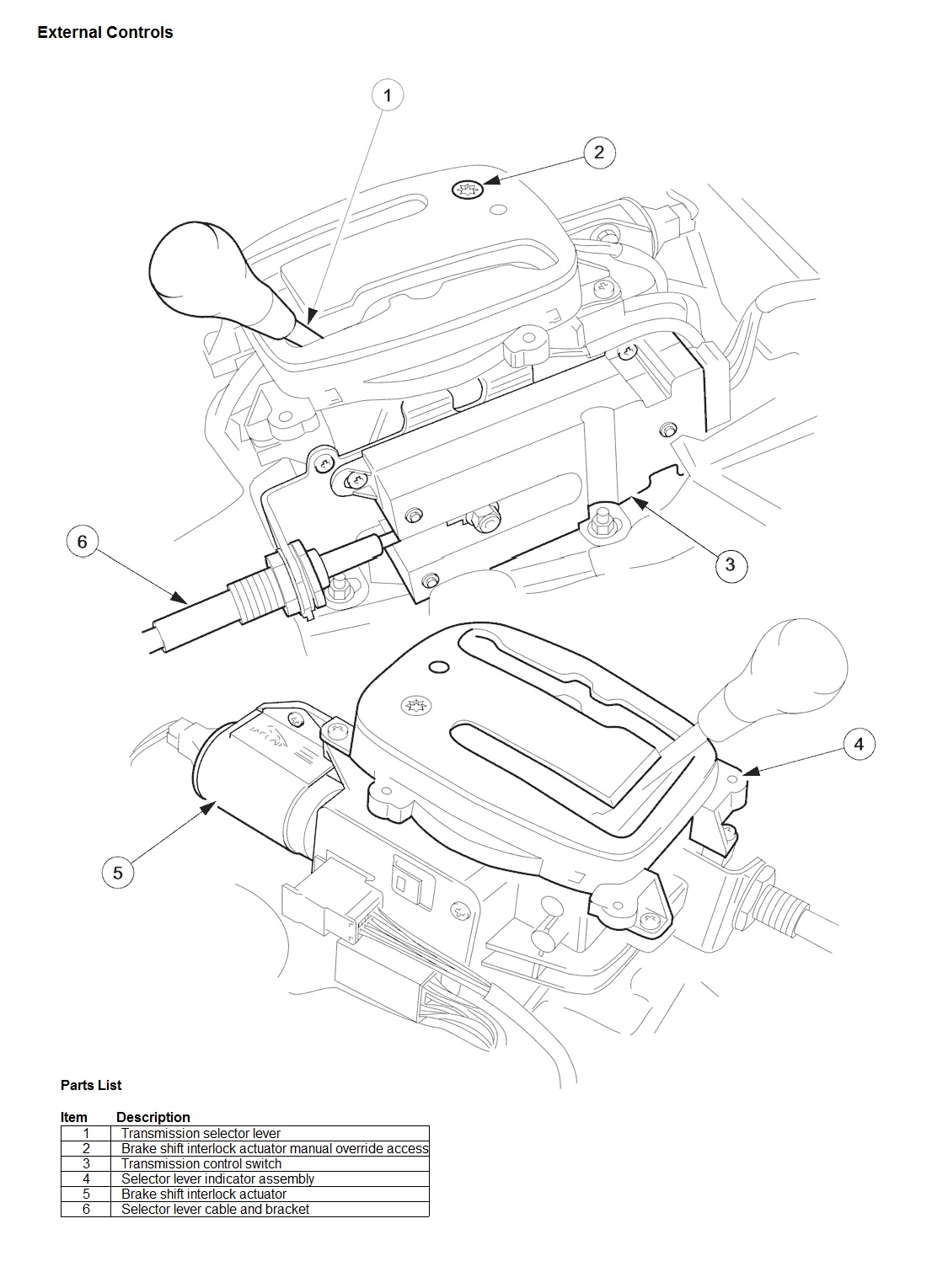

If you can't move the gear shift, it's the Interlock (item 5).
If you can move the shift lever but can't get the gears, it's the Control Switch (item 3) or Selector Cable (item 6).
The Interlock can be overridden by removing the Blanking Screw (item 2) then using a suitable tool (the ignition key works for this), press and hold the brake shift interlock actuator manual override and simultaneously move the selector lever to the 'N' position.
