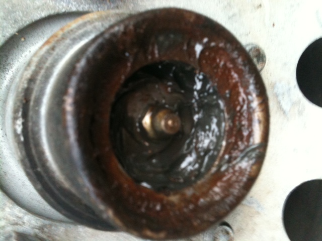

Actually, you are quite wrong. Here is a photo of a bearing on my trailer. It works exactly the way that I said that it did. There is a rubber fitting that goes over this nipple. You take that fitting off and then use a small grease gun to squeeze new grease into it and it pushes out all of the old grease just the way that I said it does.
Now you may have one that is sealed, I am not going to tell you what kind of fitting you may have on your boat trailer, because I don't know, any more than you know what is on mine. I have an easy lube axle.
http://www.wakeworld.com/forum/showthread.php?t=782730
trailer bearings should be re packed every year if you tow any distances.Bering buddy's are not your buddy they only add grease to the front side of the outer bearing which does nothing for you. the inner bearing is the support bearing.The only real system that will service bearings while still on the trailer is the easy lube axle when you add grease it goes down a path in the center of the axle and adds grease from the inside out pushing out the old grease and replacing it with new.If your trailer just has bearing buddy's the axle assembly must be removed from the trailer and bearings re packed by hand

What I meant was that there is a seal on the backside to keep dust (and water) out, and keep the grease in. My trailer has oil bath bearings which are far superior IMO. 6 years and haven't had any milky oil yet. The bearing buddys are a gimmick which does absolutely no good. The problem is that the seal gets washed clean of lubrication every time you launch your boat, then burns up with subsequent driving. With the oil bath bearings the seal stays lubricated better.
Pumping too much grease in with a bearing buddy will also damage the seals.
Adding grease down the middle of the bearings makes no difference. It still does not pack your bearings properly. The grease still has nowhere to go. It can't go outboard through the dust cap and it can't go through the seal without damaging it.
The only way to keep greased bearings lubed and free of water is to disassemble them, repack, and new seals at least once a year.
