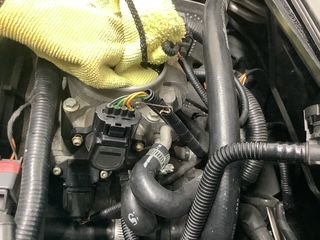

I took my car out on this beautiful day to get a few errands done and knock the dust off a little. I was thinking wow this car has been running flawlessly not 2 minutes before this happened On the way home I needed to make a left on a busy road so I had to wait a bit when I accelerated to go I got an Eng Fault, and DSC Fault and high idle around 1100 rpm so I got it off the road and turned off the vehicle. I was only a mile or so from my house so I restarted it and everything was great till I turned into my neighborhood and it faulted again (actually twice) before getting back to my house.
When I got back home my scanner easily found a P0121 throttle position sensor. The forum threads I read all pretty much said check and clean all the TB plugs and connections. So I did that and cleared the codes before another spin around the neighborhood which was unsuccessful (same fault). So I did the plugs again and did a little more in-depth look at all the wiring and this time shortly after starting the car while idling faulted again. My understanding is if it's not the plugs more than likely it is the throttle body. Joy
A couple of quick things, this is a 2003 XK8 conv. My battery is perfect and always on a tender when not in use. I'm aware of ASI in TN and will use them if I have to have the TB rebuilt.
Questions:
If the TB sensor is bad why can't it be changed to correct the problem?
Does anyone know the Part # for 2003 4.2l? I hate owning a cross over year.
Can you think of something for me to check or any suggestions?
Thanks a ton guys

I think I figured out the sensor replacement it's a Denso 198500 3300 that's what is installed in my car now. Though this sensor is not showing as compatible with my 2003 4.2 but that's what mine reads so I don't see a problem using it? Also my car build date is 05/03
Am I missing anything?

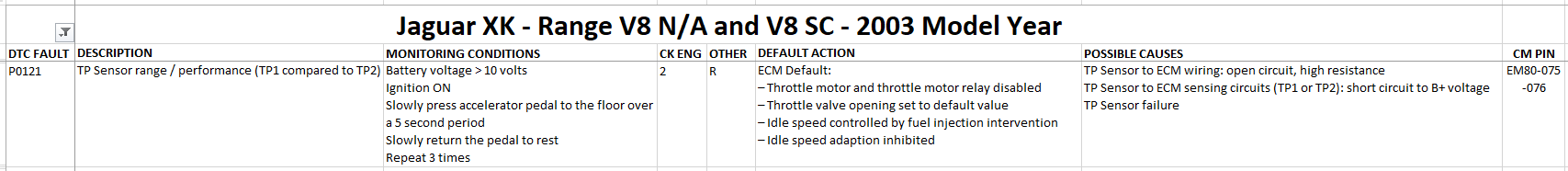

The 2003 DTC list shows how to test without driving the car:

I agree it's a cheaper option than going for a TB rebuild at this stage, although (if my understanding is correct) a replacement TPS may well throw the same code if the two outputs don't track as the ECM expects. I wonder where the rebuilders source them?
If you come across an OEM in a breakers yard I'd be tempted to grab it even if the one you've ordered does the job.
Curious:- can you induce the fault by following the procedure in the DTC 'monitoring conditions' ? That would give you a pretty definitive cause.

Hey Michael
I'm reading a lot of threads and pouring over information most times conflicting about the 4.2L throttle body and the TPS functions.
They say: No way to adjust the sensor because it is calibrated as a single unit.
Well the sensor does have adjustment slots on the sensor body soooo wouldn't that make the sensor adjustable?
The 198500 3300 TPS is very common and used on many 2003 and up vehicles.
I realized that many who had been successful in changing the TPS were on earlier 4.0 model years.
It would be great if a 4.2L owner could tell me they've been successful attempting a swap on the TPS.
looks adjustable to me?
Thanks all

[QUOTE=Shoreguy;2872859]
/QUOTE]
I recently replaced on ‘02 and adjusted the idle by rotating around the little bolts. Too far one way died, too far the other idled at 1000+, in between just right.
Old Sep 20, 2025 | 04:48 PM
Shoreguy's Avatar
Veteran: Air Force
Joined: Aug 2016
Posts: 382
Likes: 251
From: North Myrtle Beach
My understanding is the 02 were the last cable driven throttle bodies. The 2003-06 have the electrically driven throttle bodies that are supposedly calibrated as one unit at the factory. However it's still just a TPS installed at a certain mark? Well I should have my part on Tuesday and I'll let ya all know how it goes. Peace
All model years are fly by wire in that the accelerator pedal controls the throttle butterfly electronically. The earliest cars had a mechanical guard/physical override, but the normal operation is still 100% electronic.
The TPS is adaptive, so you need to physically set the position to get it roughly correct and then the car will learn the new limits (hence the hard reset mentioned above).
