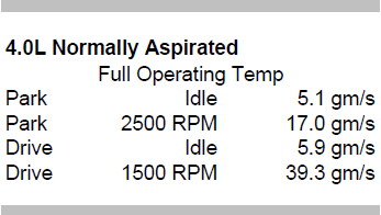

I don't have a MAF to swap so I just bought one.
I'll do some comparisons between old and new against the baseline post them here for future reference. Thanks, Steve in Indy, for the MAF data...

Way to pay attention Scott. I'll be anxious to see the comparison. Many times the MAF is erroneous only at certain flow rates. That's why the grid is so helpful. There is more to the fuel trim story yet involving load range mapping. At some point I'll get a Fuel Trim Primer Part two put together.
Standing by for your results.

Just so we can quantify exactly what's going on here, I'd urge you to use my Mass Air Flow chart you have, and record your readings at the same four points. Now that is all done at a stop, holding the brakes firmly, preferably in an open parking lot. Do that with your original air filter, and the new one, and again if you get a new MAF Sensor. That way you can see what's doing what.
This will be interesting.
Cheers,
Sure. A little 4-way test with the new vs. old MAFS and the new vs. old Filter. I have everything at hand, I can get to it when I'm back with the car early next week.
