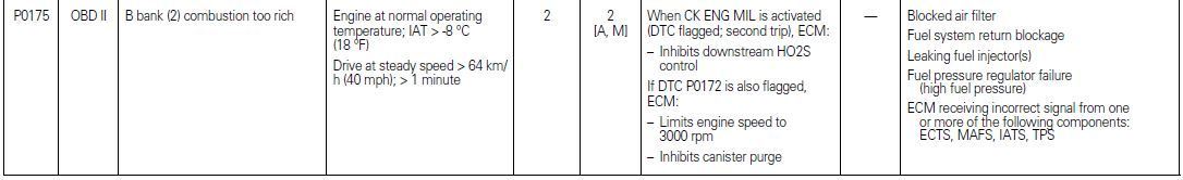

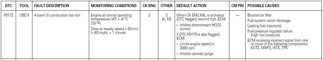

Here are the definitions and published possible causes of your codes from the DTC Summaries manual:
One common issue I've observed is that when the Engine Coolant Temperature Sensor fails and continues to send a "Cold" signal to the ECM, the ECM will continue to apply cold-start fuel enrichment even after the engine has reached full operating temperature. The same can happen when the thermostat sticks open. So while you are monitoring Live Data to observe the STFTs and LTFTs, also observe the coolant temperature signal to see if it is implausibly cool or cold or if it takes too long to warm up.
