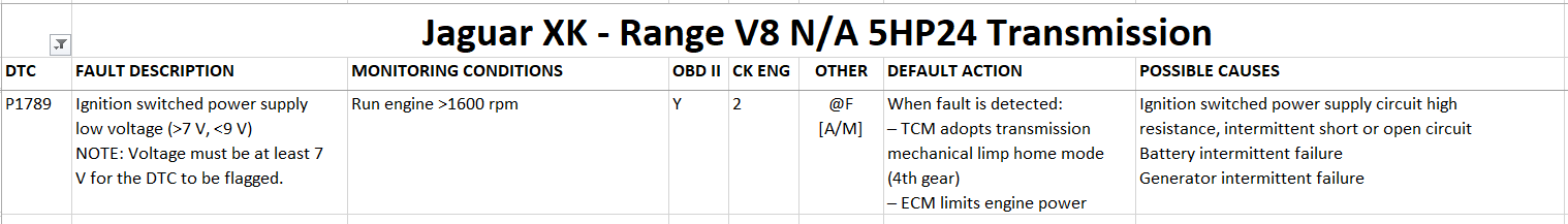

Now for my question. After installation and testing of the alternator, I scanned (Autel Maxicheck) for DTC's left from the dead battery and found only the one in the title above. I was unable to find anything further here or in an internet search. I did, however find a different explanation of the code in Rev. Sam's list in the stickies indicating a battery problem. Does anyone have experience with this code? If it is, indeed, the latter, perhaps I can erase it and see if it returns?

After erasure, we went grocery shopping (30 miles round trip). Turned on all electrics and kept an eye on the voltmeter for the first road test of the alternator. Behaved as expected. Back home, no codes of any kind. Unfortunately, I still have the X type to deal with and Winter at the doorstep.

Funnily enough we were talking about the Goldilocks zone in another thread. It looks like you have found the Goldilocks zone for just the right range of low voltage to trigger an error. Presumably they think that less than 7V the car wouldn't start at all.
When it shut down nothing electrical worked: no interior lights, no dash lights, had to over-ride the gear lock to push it out of the way, use key to open trunk. When we hooked up my son's jumper pack, it measured battery voltage as 0v.
