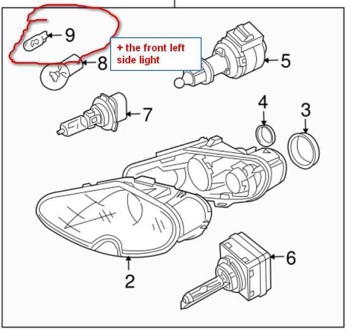

sorry everyone, it is a 2005 xk8.Originally Posted by Johnken
Wj, if you ask if there is a fuse for the one bulb, I think you can assume that no there is not. We may get confused, can you please say exactly which bulb(s) are not working? (Fender, yellowbulb in headlight assembly, other)?If 1 bulb, have you checked for voltage with a meter? Stranger things have happened than a bulb burning out right at the same time as your job got finished.
John
I installed LED Hi- (main) beams and reassembled the hl assemblies. I have read so many possible issues when fitting these bulbs to non hid assemblies that I plugged in the left side first. I noticed that both the hl assembly parking light and the front side light do not work. The hi and low do. I have not plugged in the right side because If I've caused a problem I don't want to increase my repair time.
I haven't checked for continuity but given that they worked prior to the led install I'm at a loss.

I found the parking light bulbs on the left side were both bad, the outside housing cracked which let water enter and 'rot' the electrical connectors.
