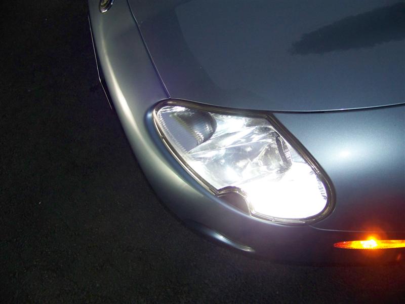

A couple pics are attached. My camera was having serious problems with overexposure to the light but it lets you get a good idea of the 6000K color. From the second picture it looks like these glare like crazy but in reality when looking at these from an oncoming vehicle there is none. The cutoff lines are very crisp and all the light is where it needs to be. I've yet to be flashed and standing 50 yards in front of the car you can look directly at them without a problem. I'll work on some better pics in the next few days.

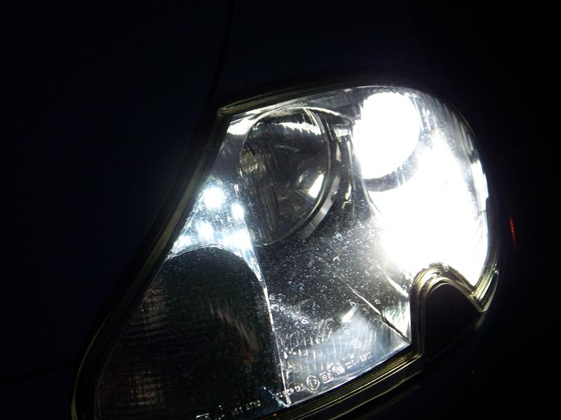

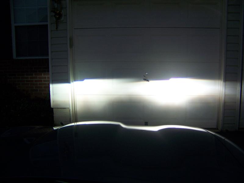

Went out this evening with a decent camera and took some better pictures. Here's a couple of shots with the LED's and the HID's. Please excuse the water spots!

Thanks, you can definitely see the color diff in that last thumb.
Maybe not a big deal, but I would check the bulb on the driver's side. It looks just askew compared to the pass side. See the bleed out from the edges? Not much, but maybe could be aligned a bit better.
I know I mentioned it before, but you could bring that pass side up a bit, so the cutoff of the driver right is aligned with the cutoff of the passenger's left side. make sense? You'll get more light on those signs on the shoulder that are higher up, and there won't be any trouble with oncoming drivers.
I see what you're saying about bringing the passenger side up a little bit. I'll spend a little time tweaking it this weekend to see if I can make the beam pattern a little more uniform.
