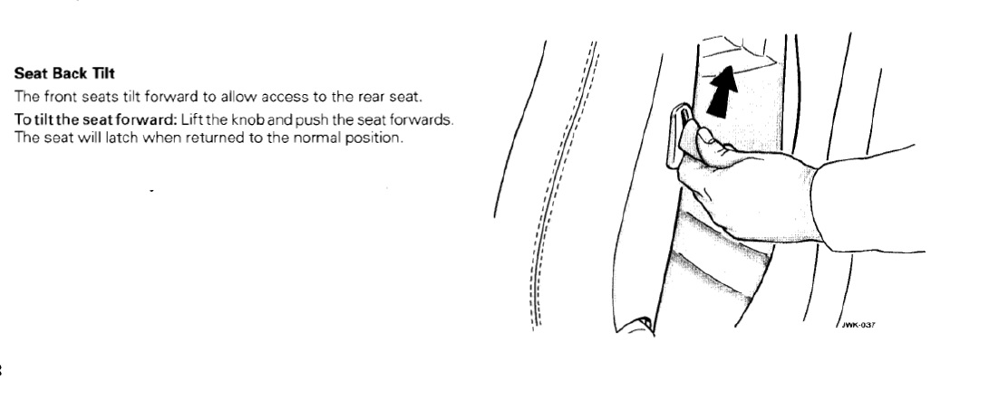

I know this is a bit of a grave dig, but I must ask, where does one find the manual release to adjust the recline of the seat?

You can't adjust the recline angle manually, only release the backs to tilt them forward for access to the rear seat.

Ah gotcha. I read it wrong. Thank Graham.
