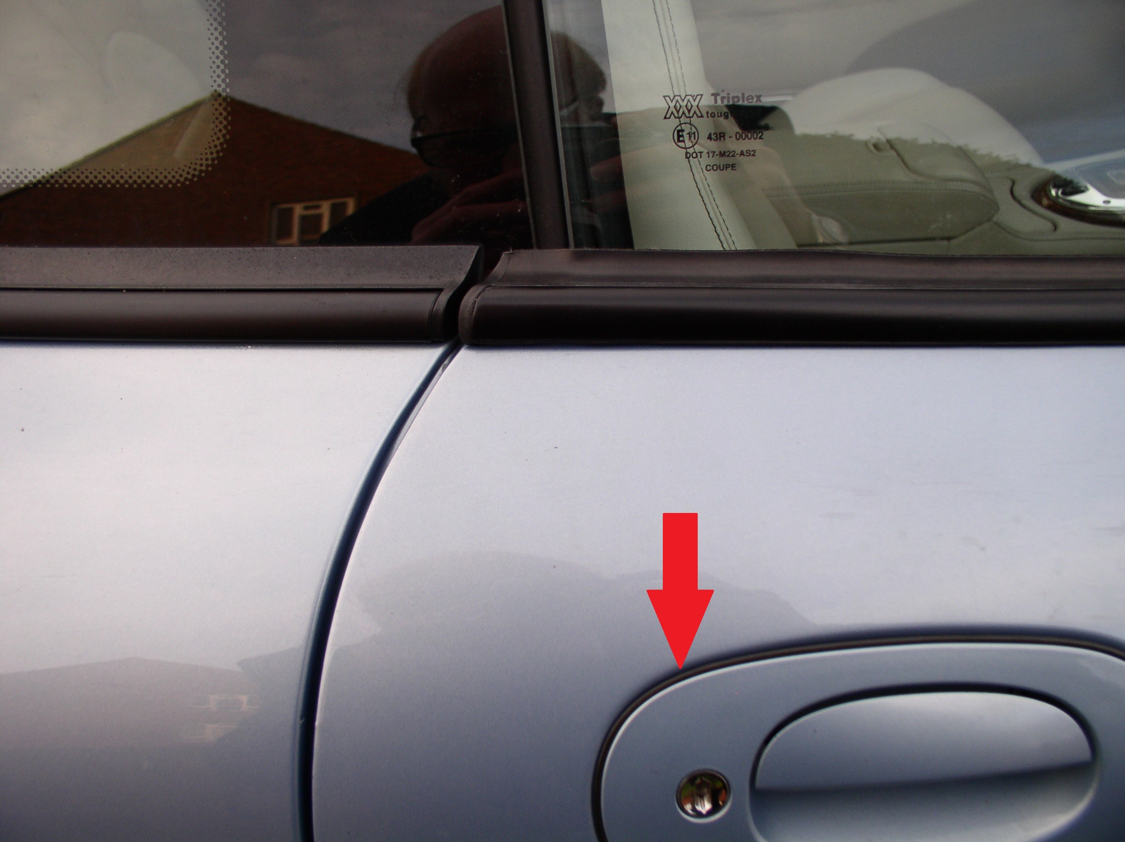

The door handle seal is the black rubber seal (arrowed in red) around the perimeter of the door handle assembly:
Both driver and passenger door handles have the same type of seal.
Attachment 77880
Think it does but , I need ask the guy who got my jag .At the moment .

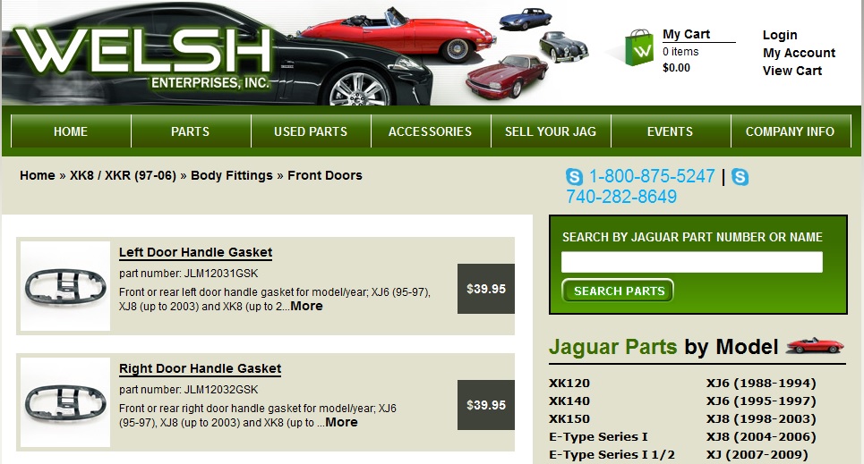

I found it at motorcarsltd in the US. Left JLM12031-GSK, right JLM12031-GSK. They sell for over $60. If you do some searching you will find that many have made their own or used silicon sealant.
Old Mar 28, 2014 | 12:16 PM
Also listed by Welsh Enterprises:
Welsh Enterprises, Inc - Jaguar XK8 / XKR (97-06) Body Fittings Front Doors Parts
These are Jaguar Part Numbers so they will be available from your dealer. This will almost certainly at a much lower cost than US suppliers. We pay a lot more for fuel but a lot less for parts here in the UK!
