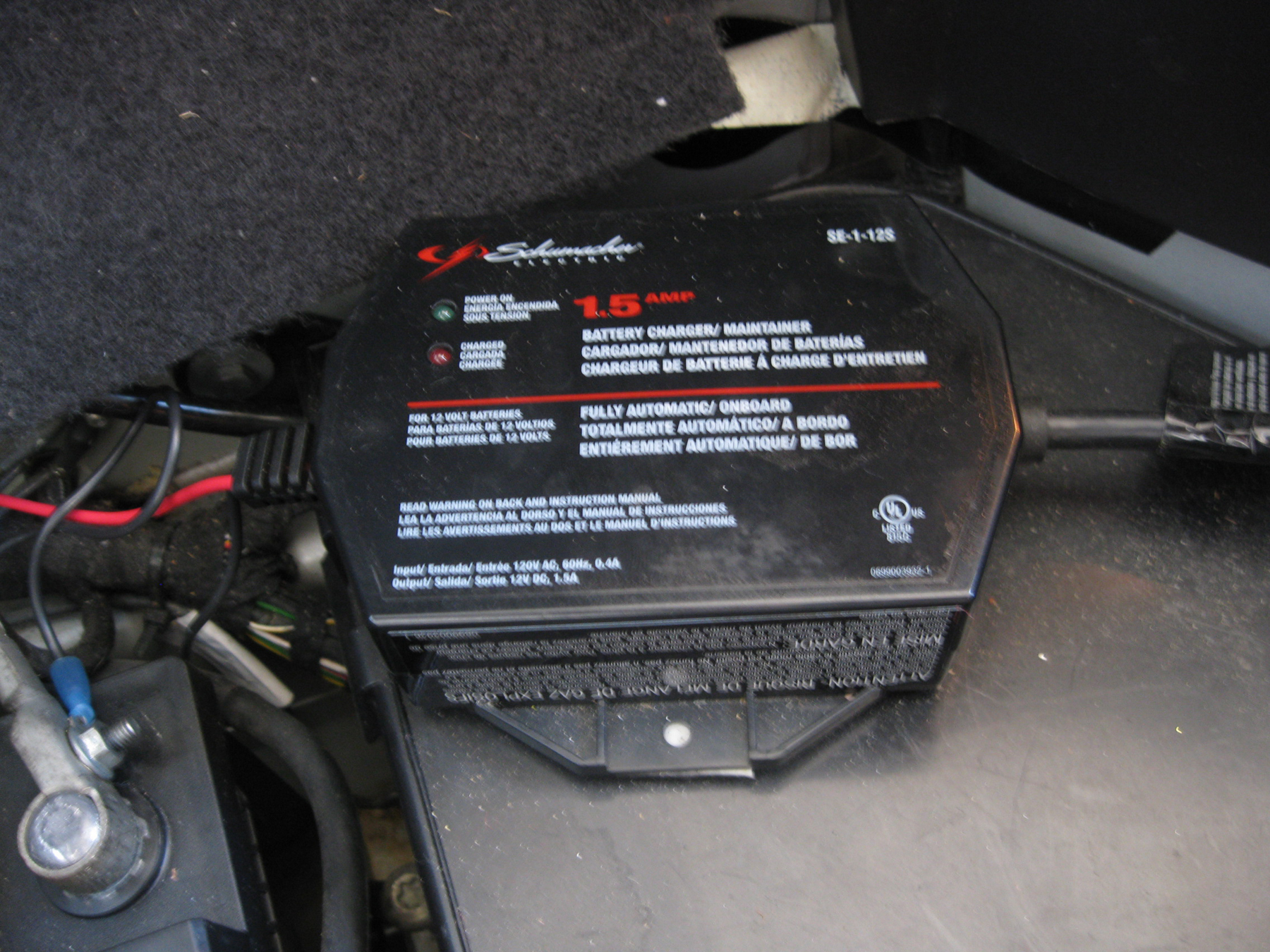

This is the charger I am using. It fits in the trunk on top of the fuse box and is permanently connected to the battery. When I need to charge it I just plug it in. Have been thinking of an external plug to the charger that I can plug it in without opening the trunk. Next project!!
Sorry I uploaded the photo twice and do not see it. I see it now.
