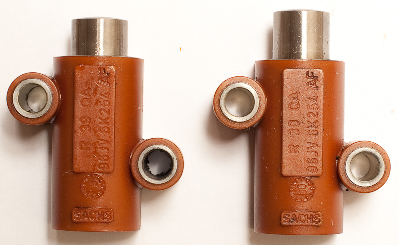

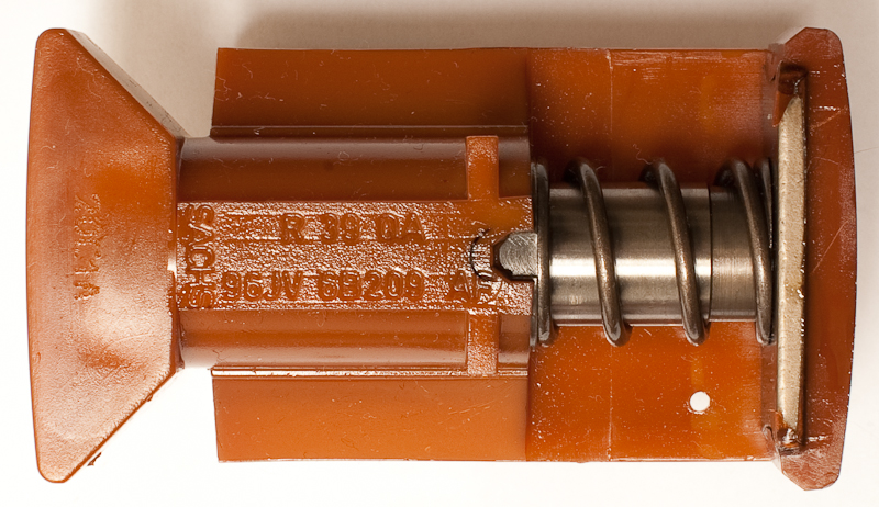

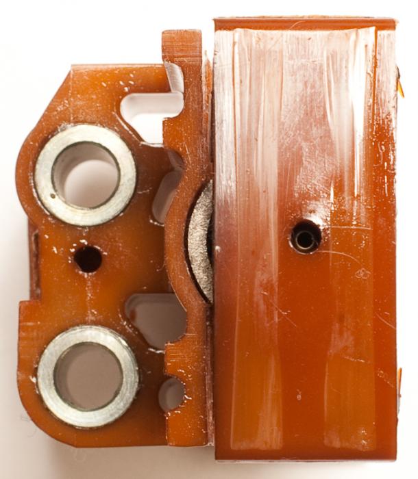

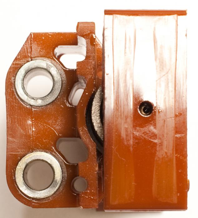

My contribution to the "show us your tensioners" thread. These came out at 67,000 miles.

Thanks for the pics. What about the primary system slippers. How well did they stand up at 67000 miles. It looks like to me that the primary tensioners are surviving fairly well and I think I'll hold off changing the primary system (40K now) especially considering how much work it will be.

I don't have the slippers on-hand, but I had a close look and they were fine. Note the last photo, DSC9063001.jpg, where you can see the plastic starting to lift at the centre of one of the secondary tensioners. I wonder what the best/worst lifespans were on these parts.

While those are in great shape, theyre plastic bodied. Time and mileage takes them out. I would only personally recommend changing the secondaries only. I only do lower if in there for another reason or if the slipper comes off the upper tensioner and gets eaten by the chain. This causes chain streach and down the road chain, and then engine failure when the upper chain snaps
In one case recorded here, a secondary was cracked at 32K miles. It is possible that there is at least one case where the secondaries have lasted the life of the car or is still on the road at high mileage.
Most people replacing and reporting at 80K+ miles report cracks, if not partial disintegration.
Both secondaries you show are exhibiting at least the start of cracking. They are almost always the same pattern and location. They are all built the same, and fail in the same way.
What mileage is on the ones in your pictures?

They came out at 67,000 miles. Jaguar didn't find any record of prior replacement; that doesn't guarantee these are the originals of course, but it's more than likely they are.
I like knowing that there are metal tensioners in there now.
