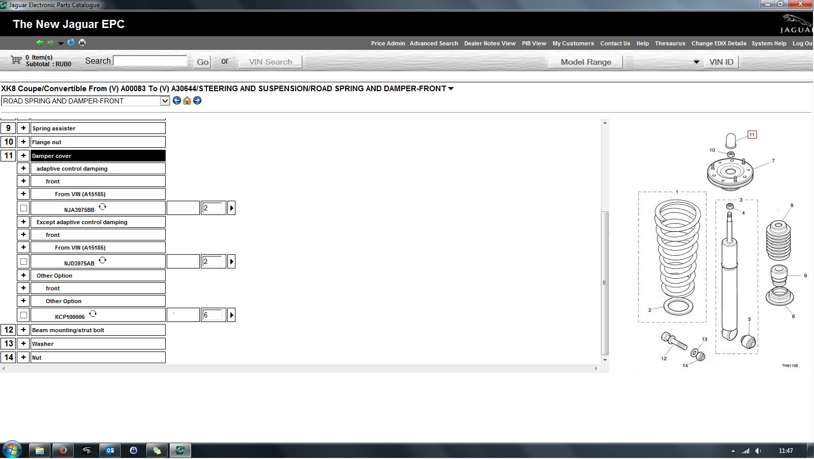

They are called a Damper Cover (see item 11):
There's 2 different sizes (later models are smaller) and 2 different types (Adaptive / Non Adaptive). Adaptive Damping patterns have an outlet for the wires.
Attachment 104394
Actually, the covers are the 3 small plastic covers that slip over the mounting studs that stick up through the fender sheet metal. They are not shown in the diagram. I needed one of them and the Jaguar Dealer had trouble finding them but finally did. The part # is KCP100006 Cap, Protective.
