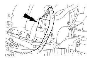

JTIS gives this:
Does your OBD scanner allow you to read fuel pressure? Would help if you could post what pressure you're getting.
Fuel pressure sensor is on the front of the right hand fuel rail (when viewed from the rear of the car). Has a vacuum hose and an electrical connector on it.

I replaced mine a few weeks back as it was occasionally leaking. You have to take the plastic engine cover off, hen you can see the rail. The sensor is at the end. Replacing it is a 10 min job. 2 screws, a connector and a vacuum line. A bit over $50 at rock auto.
