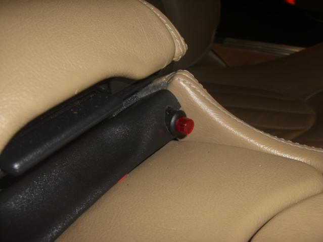

I added a switch to control when the antenna is raised. When I listen to the CD player, or around town to the radio when reception is good, I can leave the antenna in its lowered position.
There are a couple writeups on this mod. One version splices the switch into the antennae power wire behind the head unit. This mod did not work for me because my car is a 97. The other mod picks up that same wire as it runs from under the console and exits towards the backseat. I inserted the splice for the switch using this version and it works fine. Both versions are very simple and can be undone easily. The most difficult part was removing interior trim pieces to gain access to the wire. I found them by searching.
Here is a pic of the switch installed. Push the button in: Antenna goes up (when headunit power is on); push out: Antenna retracts into rear fender sheath.
