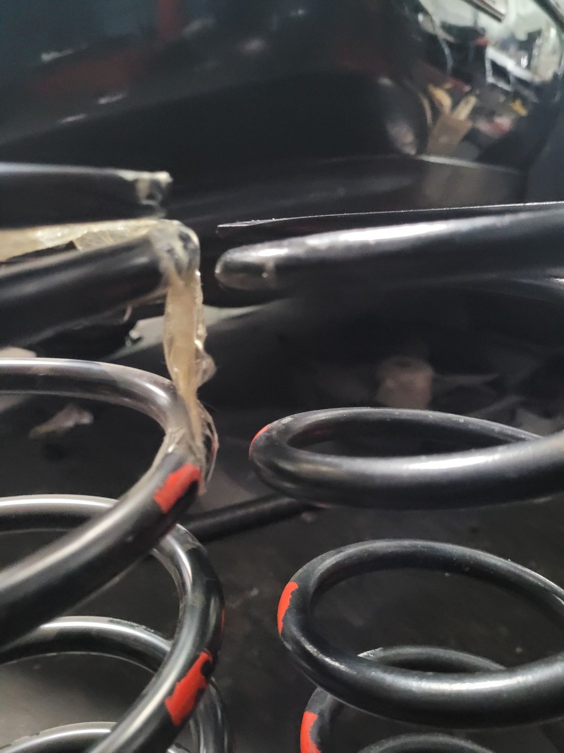

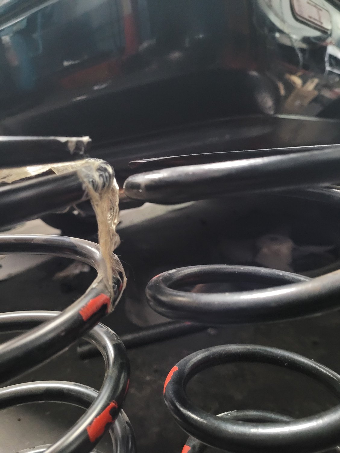

So, once the car settled, the ride height was still off. Just replaced the front springs, as suggested and the problem is solved.
Nearly an inch difference in the old vs new springs.
