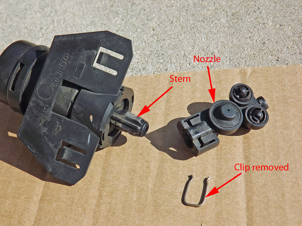

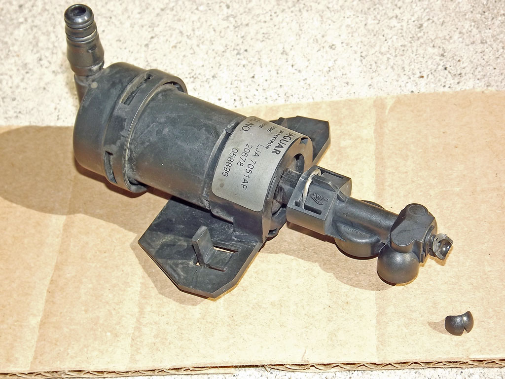

I figured that just in case it might be helpful to the next person, here are some photos of what the headlight powerwash unit looks like. The first photo shows the overall unit along with the stupid little piece that broke off that holds the shiny finisher (made of brittle plastic, don't you know). The second photo is the underside of the unit that shows the plastic tabs at the mounting piece that flimsily hold the powerwash to the headlight.

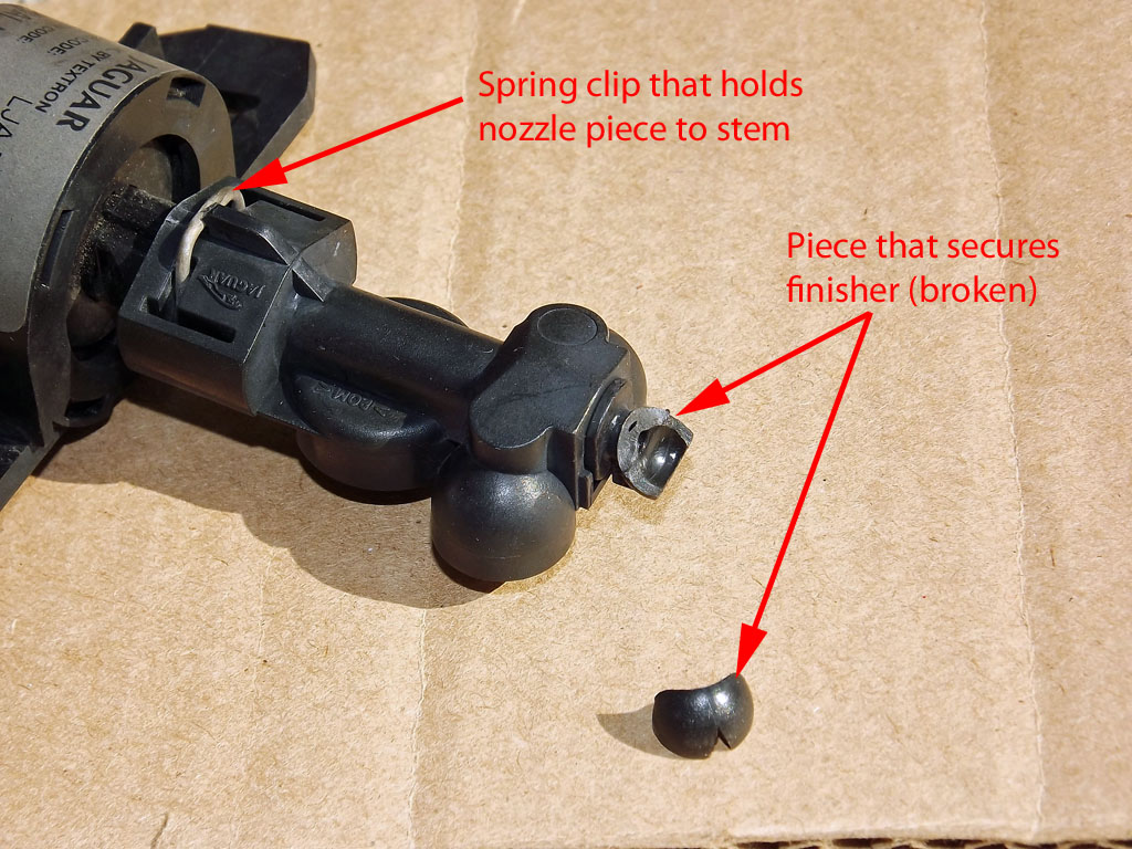

The third photo is a close-up of the nozzle area. When I was originally fiddling around with the unit still in the car I could clearly see the clip that holds the nozzle piece to the stem. I mentioned to the mechanic that this would be a simple fix if you could just get that piece and, in fact, he said the original intent of the design was that this plastic nozzle piece would indeed be a replaceable part but you can not get these anywhere--must buy the entire powerwash assembly. Had these been available the other flaw in the design is that there is no easy way to extend the stem with the powerwash in the car since pulling on it (like I did) results in the powerwash dismounting from the headlight. It would have been nice to have some way of having the powerwash extend to some "stand-off" position for servicing without having to tug on the stem.

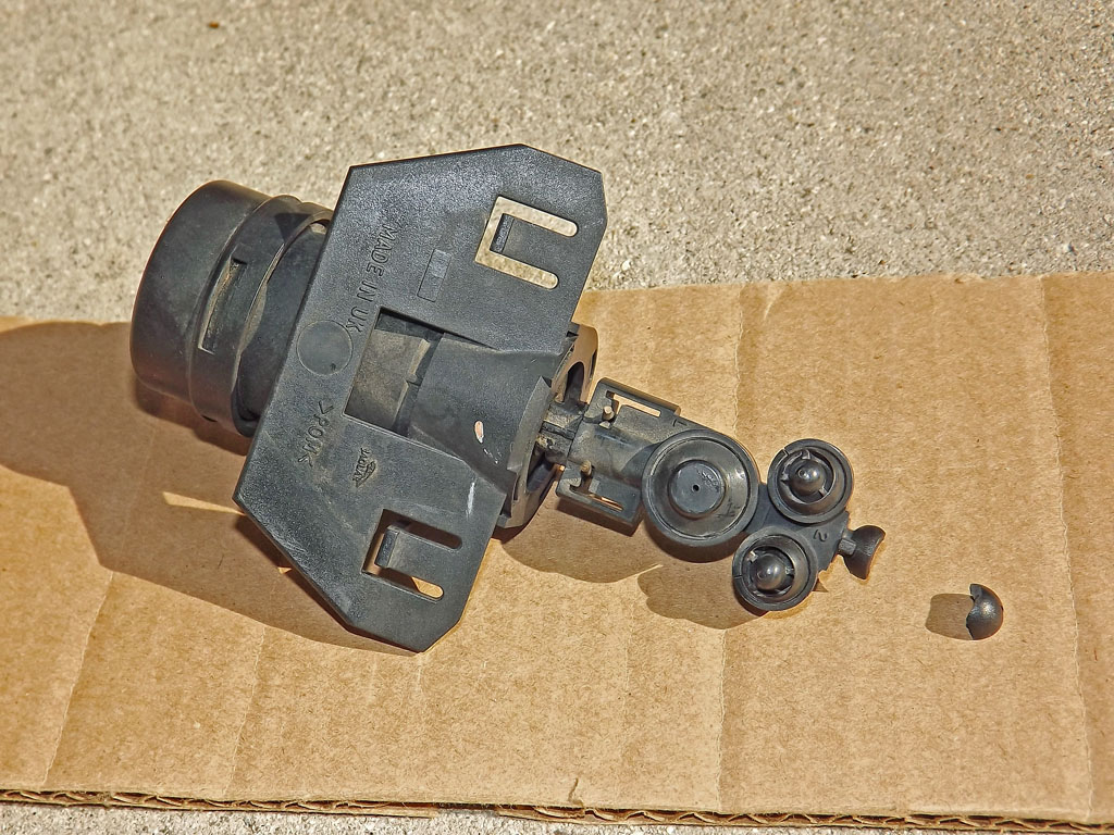

The last photo shows how the nozzle comes off the stem by easily removing he metal clip.
I might try to epoxy the little broken piece back to the front of the nozzle just to have a spare.

Well whoever manufactured this particular contrivance clearly originally intended that the cheapo breakable plastic part should be easily replaced but I guess someone had other ideas. Although the configuration does suggest another perhaps better way to deal with the shiny piece falling off. Seems to me that you should remove the nozzle by removing the clip and then permanently glue the shiny piece to the nozzle. I think others here might have also gone that route but it is much easier to do by removing he nozzle from the stem. If there was a way of getting the stem to extend on its own to allow access to the clip, this would be a piece of cake.

that is exactly where mine broke off, and that tiny piece along with my jet cover is somewhere on a street in LA. luckily, the dealer had a new jet cover in stock (part #LJA7054FA) and i just used a tiny drop of gorilla glue to reattach. i dont ever think i will use the headlight washer since i hate the mess it makes all over the front skirt...so if i just glued it shut, oh well.
