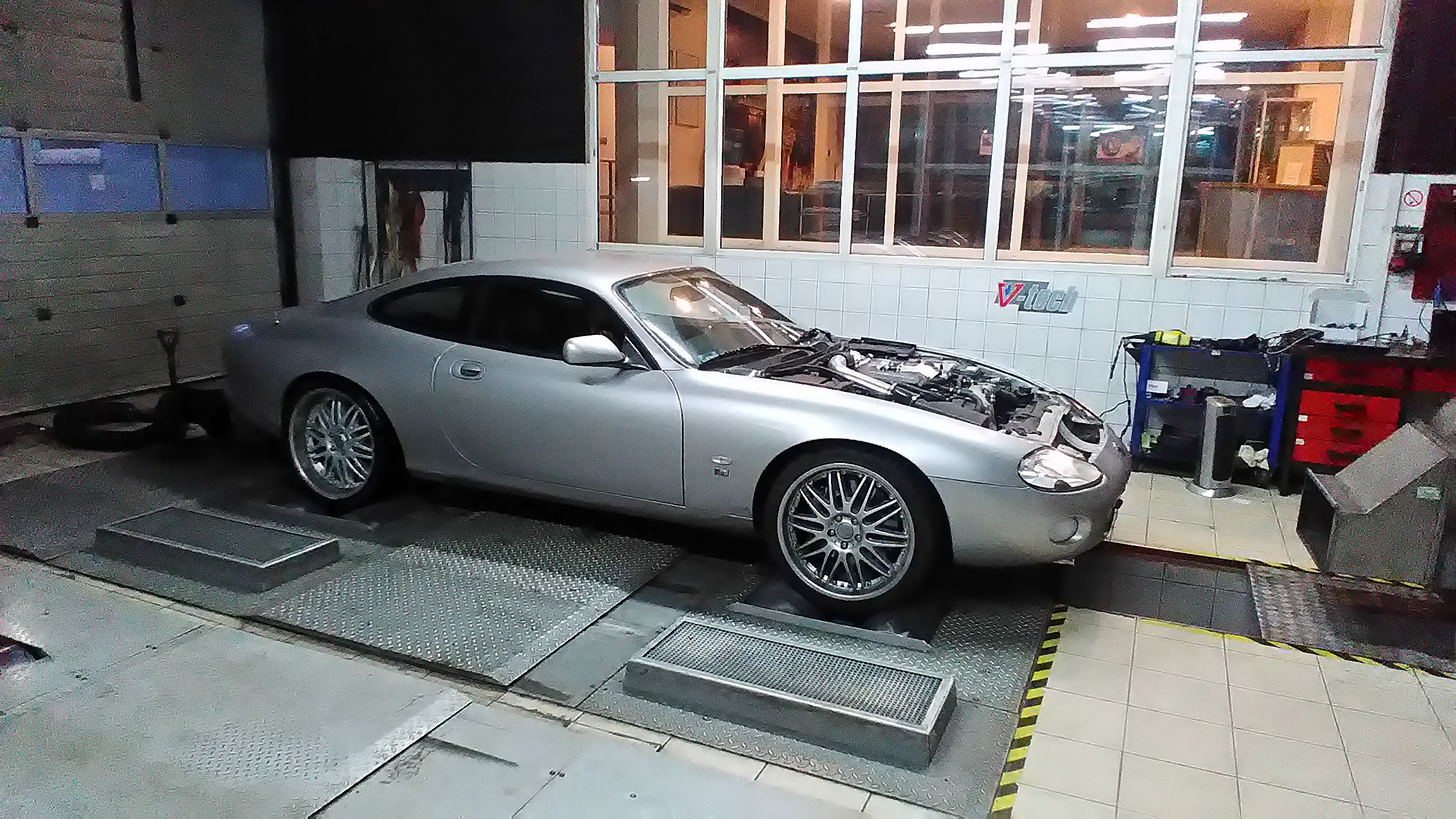

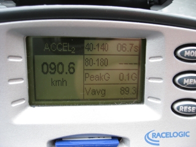

2 weeks ago I took my car for a ride to know acceleration times. The car felt quick. I measured 40-140 km/h and 80-180 km/h times using Racelogic GPS device. Tests were made in poor weather (slightly wet road, low temperature: 36F). I think results aren't bad (newer XKR 510 makes 80-180 km/h in 8.4 sec nad 40-140 on 7.1 sec according to zeperfs.com).

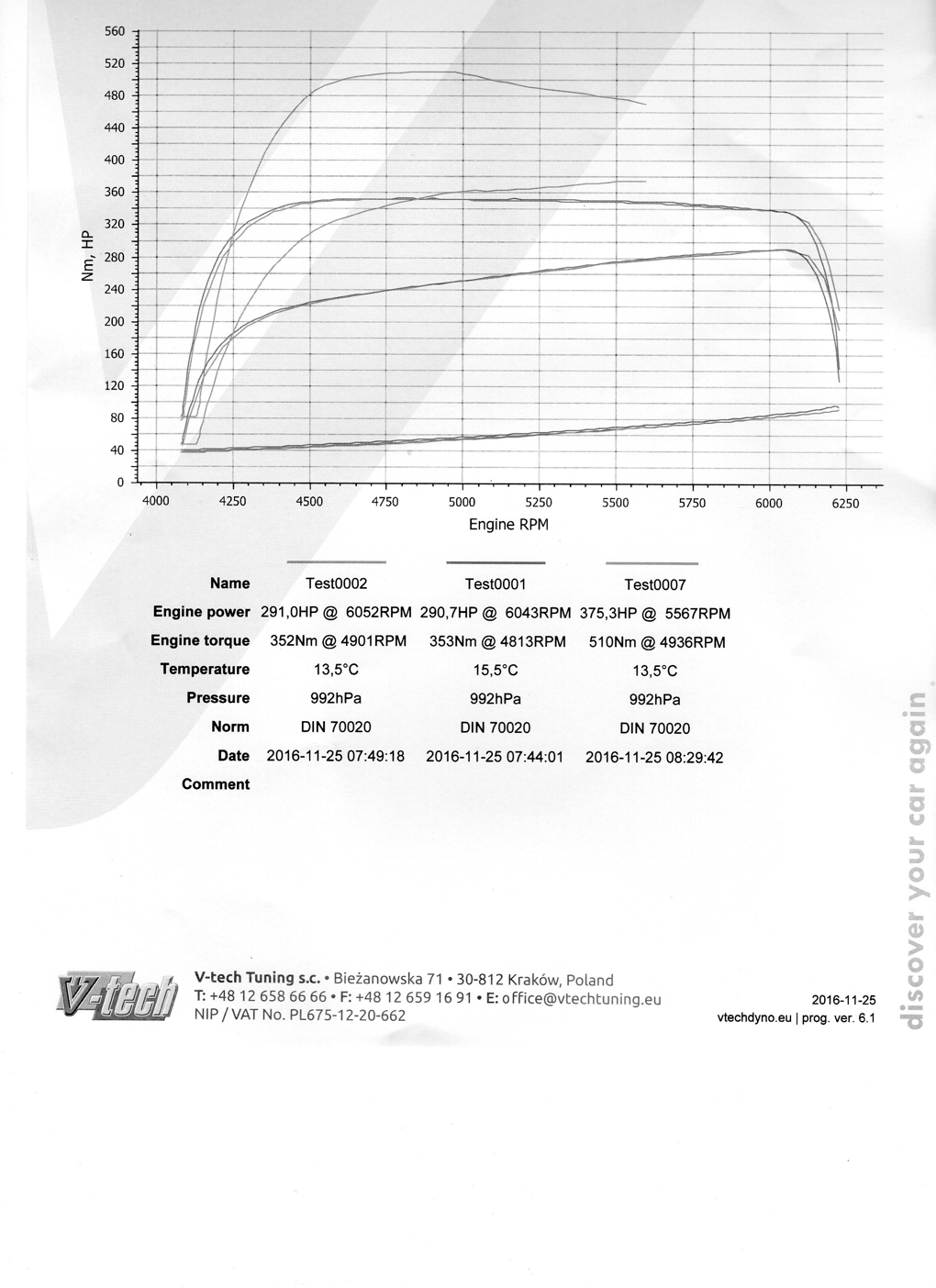

Yesterday I took it to dyno to check numbers. First run showed... 291 HP and the second one 290.7 HP at flywheel. We decided to check boost. I saw... 4PSI rising to 5PSI at redline. The reason of this situation was blocked bypass valve (as opened). Bad HP result but, comparing to poor boost, not so bad I think.
Then I closed the bypass valve manually and blanked off vaccuum hose so the valve remained closed. Boost has immediately raised to 16 PSI but at 5500 rpm acceleration was suddenly stopped. The same situation was in the second run. Dyno showed 375 flywheel HP at 5500 rpm, so poor HP gain comparing to boost gain (+12 PSI!).
Do you have idea why Jag is cutting off at 5500 rpm (it felt as if speed limiter kicked in but it wasn't speed limiter)? Lack of fuel? Unfortunately we didn't put AFR in exhaust tip.
Attached Thumbnails Probably another Kenne Belled XKR-rl_1.jpg   Probably another Kenne Belled XKR-rl_2.jpg   Probably another Kenne Belled XKR-eng_1.jpg   Probably another Kenne Belled XKR-eng_2.jpg   Probably another Kenne Belled XKR-view.jpg

Are you using the stock MAF or an aftermarket larger one? If you exceed the max input voltage to the ECU it feels like the speed limiter when it shuts everything down.

My 1st guess would be exactly the same as ccfulton has mentioned. Maybe it shows a DTC for high voltage, iirc the system pegs at 4.85 volt.

I would check two things first with UltraGauge or other OBD reader.
1. MAF readings should max 400g/s and that's enought for 520bhp+
If the intake filter is too small it may max at lot lower.
I have tested this.
2. Throttle is open up to 100%
It has been dynod 520bhp+ with stock MAF and TB at 16.7PSI / 5950rpm KB2.6H. With very good intake, stock MAF and bored TB a few tens hp more @20PSI.
I guess you have stock fuel pumps and FPR ?
I read the website of your dyno company. They seems to be manufactuer for dynos - so we don't know how to compare the readings vs more common dyno brands.

Results from vtech dynos are comparable with other brands (up to 3%) so results are reliable.
Yes, I have stock FPR and both fuel pumps (never touched). Throttle line was adjusted.
I'll log the car and check things you mentioned: MAF readings (maybe it's out of order) and throttle opening position.

The behavior described does sound like it could be the MAF cutting off power but a properly working stock MAF should be good for over 500 hp.
What size is your intake? From the pictures it looks too small and restrictive.
