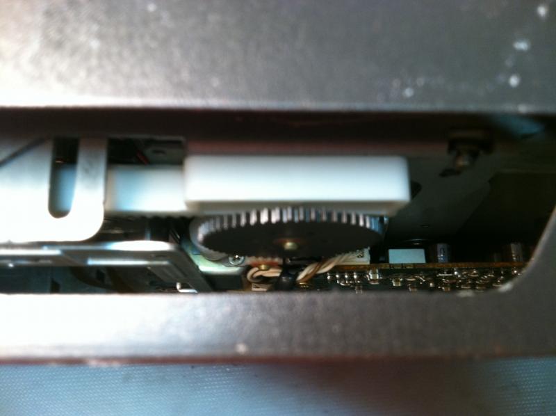

OK, I am a fair enough mechanic for the usual maintenance, but this CD changer fix seems to have the best of me. Took changer completely out of the frame where I could easily get to the gears. Still doesn't travel full length and I can't seem to get it past its stopping point. Can't see how to remove the drive gear as suggested in the older thread (looks riveted on?), so I have buttoned it up for the night.
I have the changer sitting on my bench and if I get a break from the Father's Day activities tomorrow, I'll give it another go.
Attached are pictures taken during the process, minus of course those that are not suitable for viewers under 35. (Will blood from your hand short out the wiring?) Maybe this will help someone.

Decided to attempt the changer fix again. At one point yesterday, the FM side of the radio had stopped working. Today, with no assistance from me, it is again working just fine.
I got better access to the worm gears on the changer and worked them to what I think is the full stop position. But when I hooked it up to test, the head unit no longer recognizes CD mode. I have tried all the controls to switch it, but it is not recognizing CD mode in any fashion. The fuse index shows radio/tape only and the radio is OK. Is there another fuse for the CD player or have I fried something? I'm sure this will be humorous someday, just not today.
