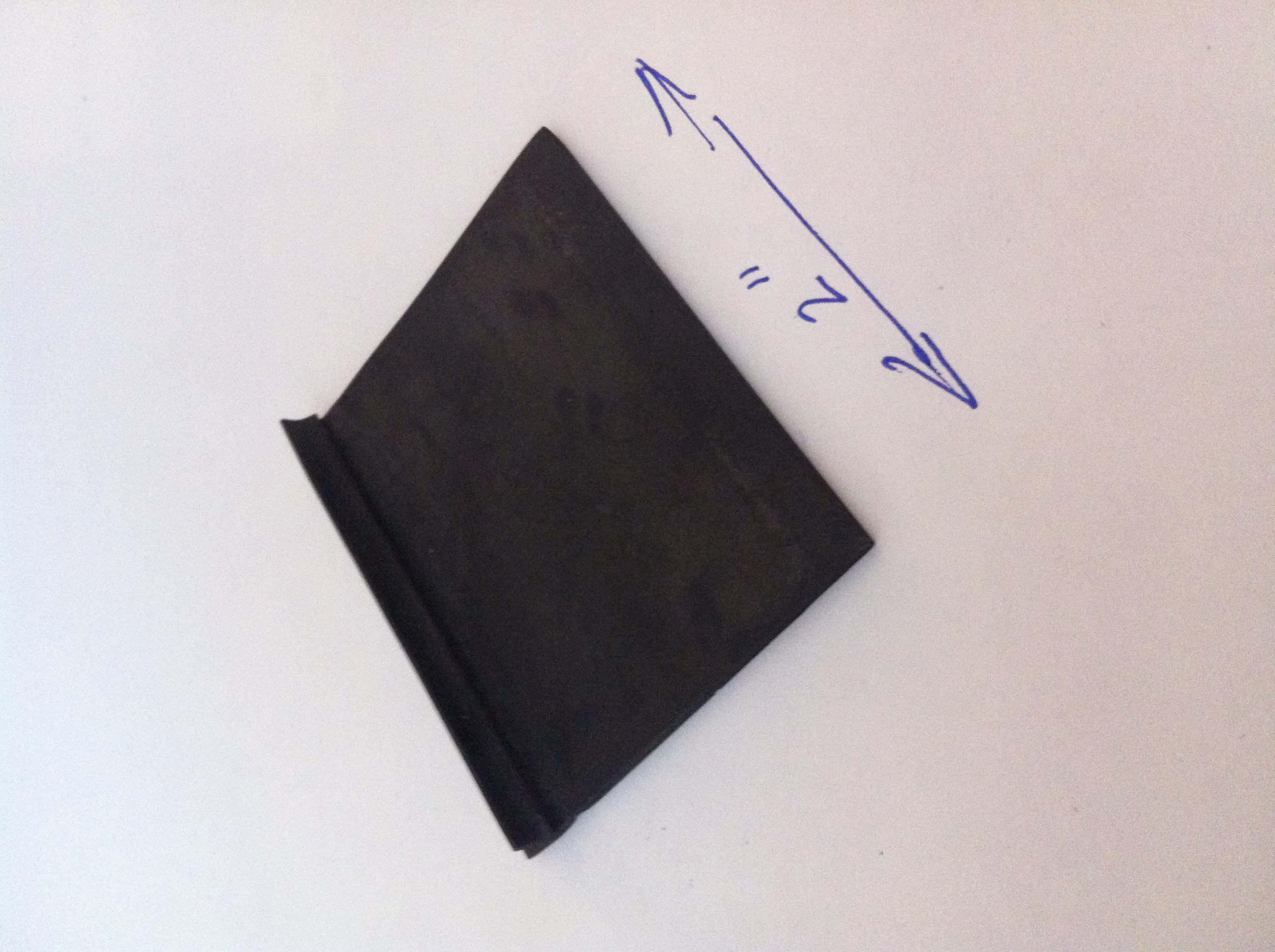

and found this during reassembly. looks like a flap for something? any guesses?

I have a 2003 XK9 that I pulled the intake also to do the valley hoses and didn't see that laying around under my intake.

Yep, got one on my '02 4.0L
where?

Originally Posted by stevepaa
where?
Almost dead center on top of the engine block, at an angle to where it looks like a diamond. I believe mine is held in place by an adhesive? I'm out of town for the moment otherwise I'd take a pic for you. I'm in the process of doing all,my cooling hoses as well. Get all that you can through rockauto.com they are about 1/2 the price of anyone else online. No, they don't have the octopus hose, SNG Barrat has that one for the lowest price I could find. Rockauto does have that stupid hose that goes between the thermostat and the water distribution contraption that normally goes for 20$ for about 3$. Worth checking into.

Thanks. wonder what it was for, car works fine without it.
like to see your pic of it. I might put it back in.
Will do when I hit town this weekend
