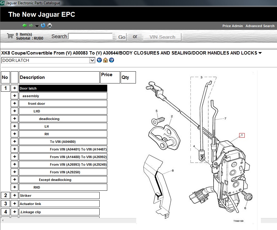

Thanks guys! I replaced the window micro-switch on the driver side of a conv about a month ago. Now the passengers side door lock got stuck locked which looks like a mechanical issue and not a micro-switch. I found the entire door lock from a low mileage coupe and was pretty sure the part was the same but wanted to make sure.
Old Apr 24, 2014 | 05:34 AM
Likes: 17,008
Originally Posted by seawind
........ I found the entire door lock from a low mileage coupe and was pretty sure the part was the same but wanted to make sure. .........
It's always the details that make the difference!
Coupe and Convertible use the same Door Latch assembly BUT
1. different options for deadlocking / without deadlocking
2. P/N change with VIN range
Check it's compatible to avoid any strange door lock behaviour.
