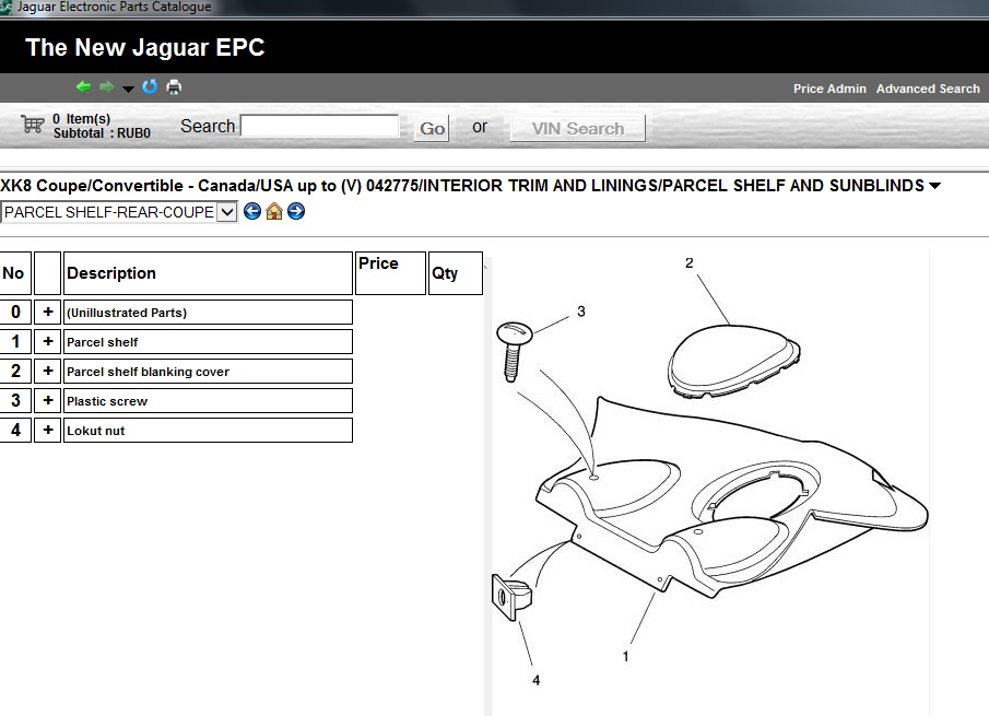

Here's the Parcel Shelf fixings:
I haven't needed to take one out but it looks straightforward.
