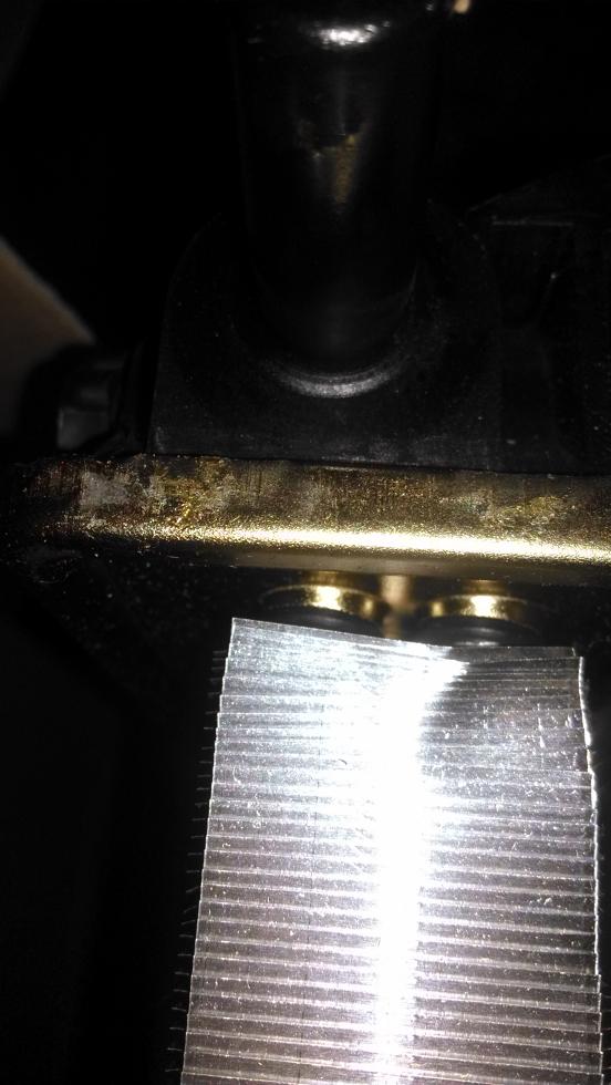

Here is some information about radiators that I couldn't find in the forum that eventually someone will find helpful. Due to a leak in the usual place on my XK8 radiator, I was searching for a reasonably priced replacement. Several members have installed Nissens, so I bought one from RockAuto. It was the least expensive radiator that I ever bought, and I know better. Went down that road with a Grand Cherokee. I don't know about the other brands, other than many of them are also Nissens, so be aware. What I want to do here is to show the difference between the real OEM and the claimed OE. Shown are the Jag part on the left and the Nissens, right. Note the amount and size of the coolant tubes (25 on the Nissens, 50 on the Jag) and the fin construction.

Seal channels on the Jag part, left, none on the other, right.

A closer look. Jag on the left.
