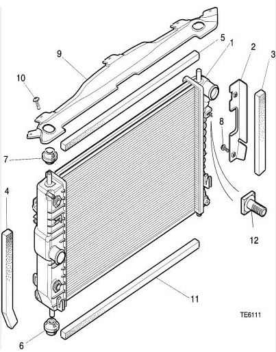

There's a metal shroud attached to the RHS of the radiator (#2 in the attached) which you will need to remove as it encloses the A/C lines.
It's held by two torx bolts on the front but they are a fiddle to get to.
Good luck.

#2 in the diagram is a bracket that holds tubes connected to the condenser. I didn't find it too hard to get to from the bottom front. I couldn't get to it from the top. Also loosen the other clamps for the condenser hoses near the radiator, and also the drier/accumulator, that will give you the wiggle room you need. Note that the transmission cooler inside the radiator holds about 1/4 cup of fluid as I remember.
