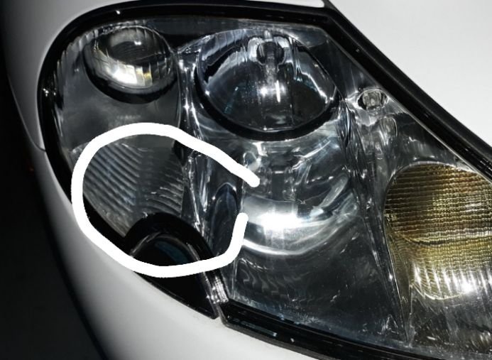

Black, Ridged ? what ar you on about ....??? The chrome trim within the headlamp unit ?

Yes, see picture below (with thanks to wymjym), on my LH headlight the circled area has lost most of its reflective surface.

none of that area is important..it has nothing to do with the beam pattern just cosmetic
that is incorrect, the veined area diffuses the light
wj

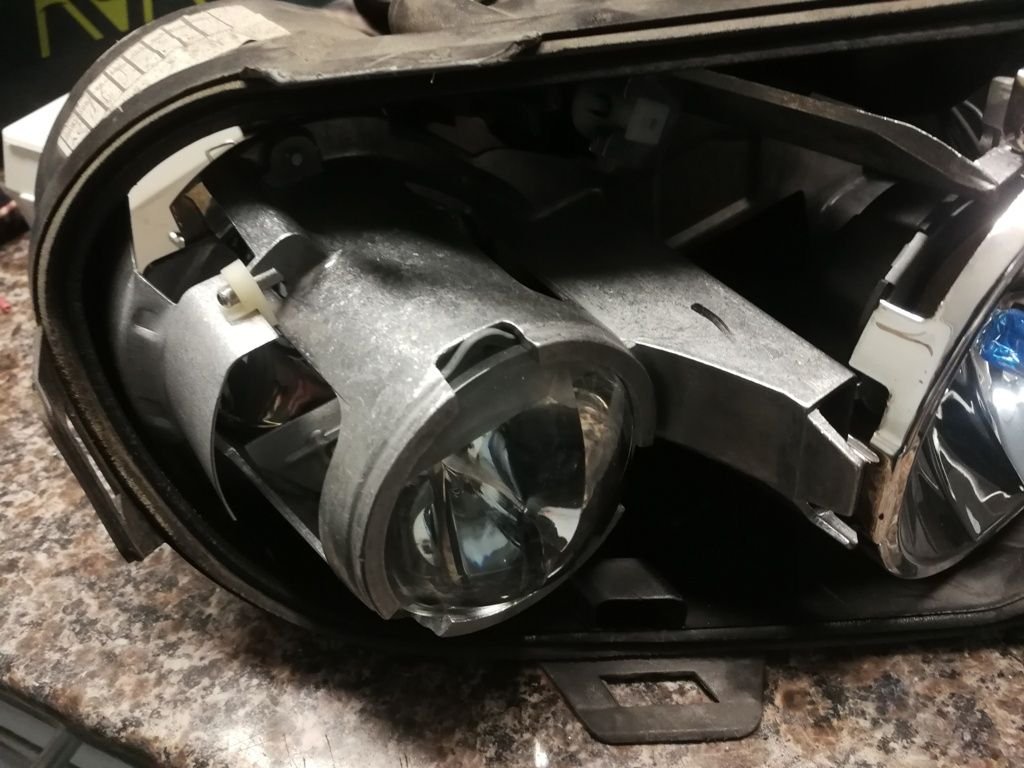

Some confusing here....
The main beam reflector is steel not plastic (I've just tested it with a magnet)
The reflective plastic that is bonded to the glass lens is another thing.
You dont have to remove the glued glass to get access to the MAIN BEAM reflector.
The headlight assembly is made up of two parts that are just snapped together, the rear part witch hold the main beam reflector and low beam projector, and the front part with the glass glued to the reflective plastic part.
In US (or some states) they want to diffuse some light upwards to light up overhead traffic signs. I dont think that relates to any country in Europe.
I have painted mine black, and it will do nothing to the actually beam pattern or light output on the road.
