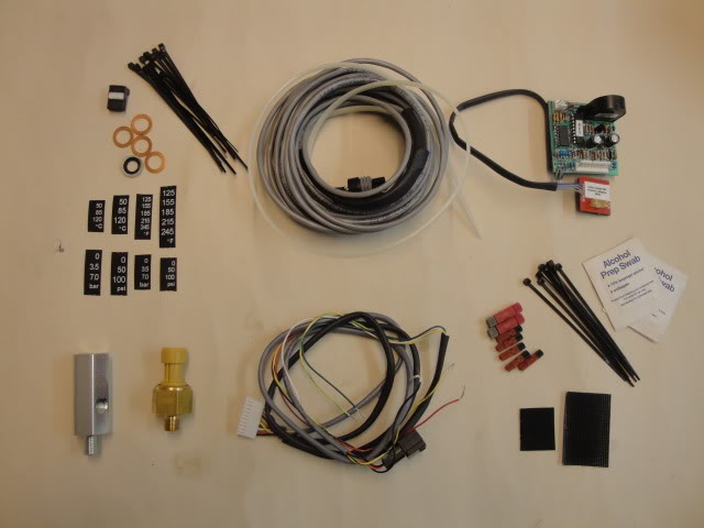

Now that the kit itself has arrived, the dream, if it was, has come true! It had been despatched before I'd even got over the surprise of winning it and when it got here, in UK, there wasn't even any import tax charged.
Life can be good! It all came well protected in an extremely well packed box with all the various items bagged up in appropriate groups and for a guy like me, who revels in this sort of project work, the quality of the individual parts and the completeness of it all, right down to the last alcohol wipe and tiewrap suggests that fitting it will be a hassle free, enjoyable experience!
Whether you win this kit or buy it, you just have to be excited when it arrives and you open the box.
Couple of pictures here just to show you how it arrives and what you get:

The actual business of fitting the RealGauge module will come in due course and I'll try to give a good account of it, but let me say right here and now that the published instructions for fitting, by WhiteXKR, posted at his Jagwrangler website leave little to chance, guesswork or imagination; they are specific to the finest detail and if you go with this upgrade, you won't need any extra guidance from me!!
The prize of course includes the optional extra bits to extend the true gauge reading feature to the oil pressure gauge as well as the coolant temperature.
As my car has the satnav option, at first glance this would seem to be surplus to my requirements, but I don't intend to give up too easily on this one!
It's an awkward situation; despite its lack of updating, here in UK I don't find the satnav to be quite as bad as it's sometimes painted and at present I'm reluctant to remove it. I'm more inclined towards feeding a modern satnav into it as has been covered on this Forum, plus perhaps a reversing camera.
But I would like to have oil pressure indication and I definitely want the low pressure audible alarm aspect of RealGauge, so without wanting to worry WhiteXKR as to what I might do with it, I promise I won't compromise the kit!
A bit more exploratory work is required by me on how to best achieve this before I start that part of the installation

As for oil pressure on your navigation equipped car, RealGauge will give you a low oil pressure audible alarm even without the oil pressure sensor installed. This is based on the low oil pressure switch already in the vehicle.
If you want to keep your nav, and add an oil pressure gauge, your best bet is probably any one of a number of afftermarket oil pressure guages avaialble. You can mount it on the A-piilar or on top of the dash. The tee adapter and associated hardware in the RealGauge kit will still be invaluable for connecting the sensor to the engine. Usually aftermarket gauges come with their own sensor, so just make sure it is has 1/8 NPT threads to fit the adapter (this is the most common type).
