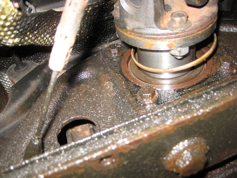

Not a big deal, the new seal assembly was about £150 and I was charged two hours labour by my local Jag indi, £250 all in. Looked like an easy job compared to how it was described in JITS.
This is how I found mine.

Thanks for the advice. BTW, what is that orange stuff on the metal? Oh, I remember now, you Brits call that rust. Don't see much of that in California!
