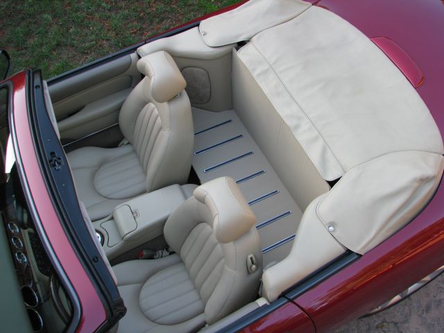

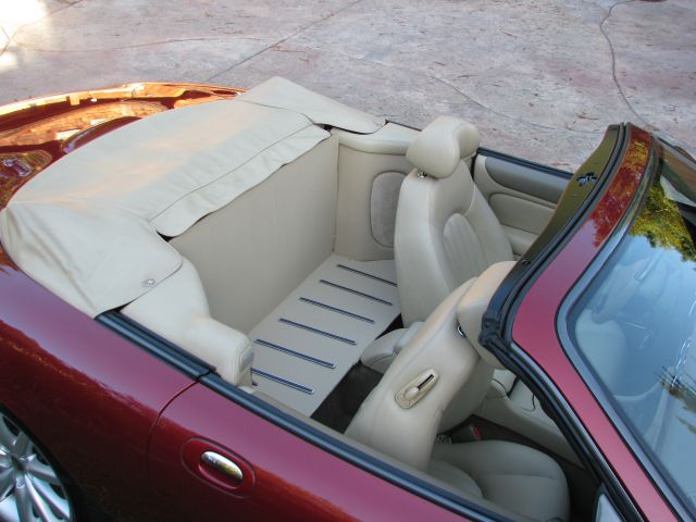

Now I need to source matching vinyl and find a supplier for the luggage strips (I made everything from painted cardboard). Underlay foam and plywood are available locally of course.
Attached Thumbnails Rear seat delete mockup finished ...-img_9304resize.jpg   Rear seat delete mockup finished ...-img_9307resize.jpg   Rear seat delete mockup finished ...-img_9305resize.jpg

Looks like you are well on your way design-wise. Looks very nice and has to be more practical.
Have you considered some straps or hooks to fasten things down?

Well, that looks good, but, what is it that you need to haul around in the back seat area that requires the little bit more room that you get from this, over the regular seat?
You are going to need to find something to hold down that flap that normally tucks in behind the seat. The way that you have it there will probably lead to it flying up at speed and maybe even pulling the whole cover off. It shouldn't be a problem to fit some Velcro or something to secure it.

I thought about straps ... most of the older Ferraris have them. Often in matching color. I haven't decided on that yet.
I read your post on the U.K. connection for luggage strips. Thanks for the input. They are polished metal which looks pretty cool, although I like the idea of rubber-faced strips as well for more of a non-slip function.
The final version is not going to have the flap in that position. I will have a four inch finisher on the top of the backwall, so the flap will tuck like it's supposed to. I just hadn't mocked that feature up this morning when I took pics, so I laid the flap in position to cover the gap.
I considered carpet .... laid the floor mats back there to get a feeling for what it would look like and it seems too dark for my taste. I'll probably never haul anything more extensive than my gym bag, so I'm not concerned about scratching the vinyl. I just think the rear seat looks silly, so decided on the delete.

I'm having a surprisingly difficult time finding luggage strips ... my name for those rubber (or vinyl) and metal strips that I mocked up on the horizontal shelf part of the delete arrangement.
I like the metal strips from the U.K., but they are too long. I've tried googling half-round metal extrusions. but so far haven't found anyplace that sells at the consumer level.
Any ideas from you folks? Do you know of other cars that might have 12" strips as part of their interior? I can buy strips in 4 or 5 foot lengths, but they are meant to go on top of a minivan and are self-adhesive. I was thinking something that I would fasten with screws through the vinyl into the plywood underneath.
Another alternative would be wooden strips stained to match the dash. That actually might be kind of cool. And maybe stain the cap-rail at the top of the vertical back piece. What do you think?

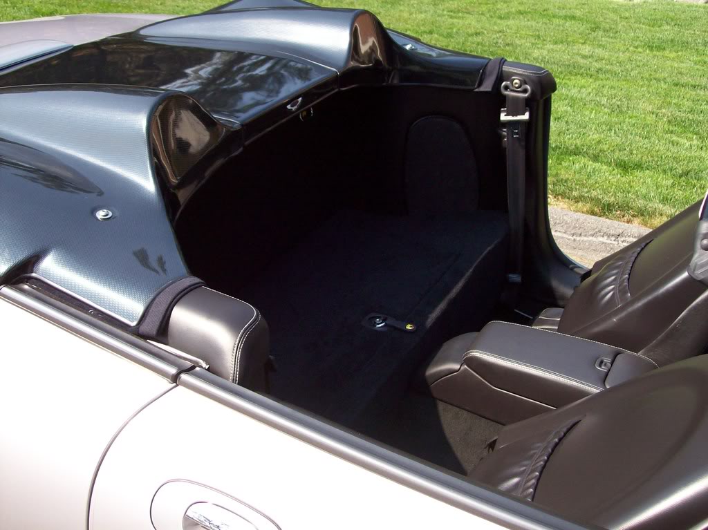

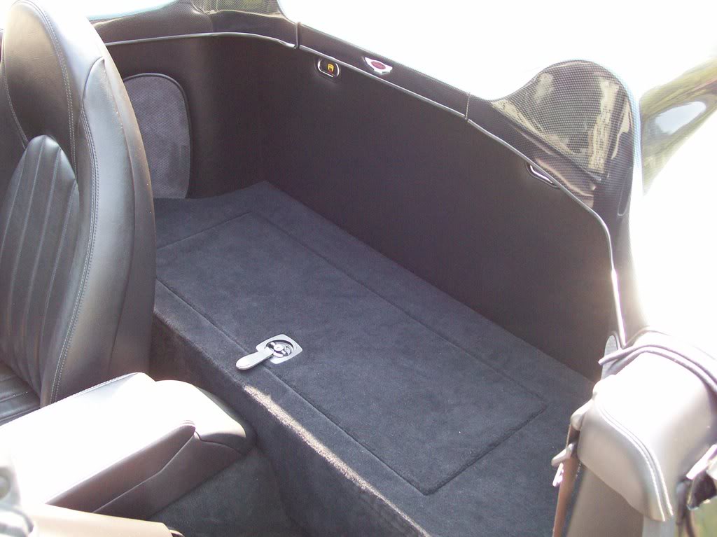

Here are a couple of versions I have used over the years. I used carpet on the bottom as it was easier to work with.
Attached Thumbnails Rear seat delete mockup finished ...-004-2.jpg   Rear seat delete mockup finished ...-008-4.jpg   Rear seat delete mockup finished ...-145-1.jpg   Rear seat delete mockup finished ...-100_0490-1.jpg   Rear seat delete mockup finished ...-100_1067.jpg

Looks good but is there any way to possible pad it a bit or add some stitching? To the back? Something to follow through to the front details?

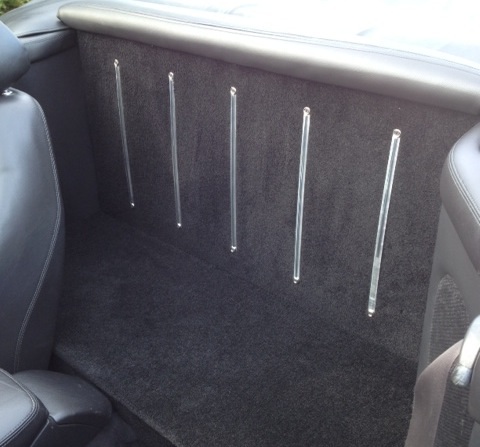

Finished mine. Since pic I added bottom rub strips too. Best thing I ever did!!

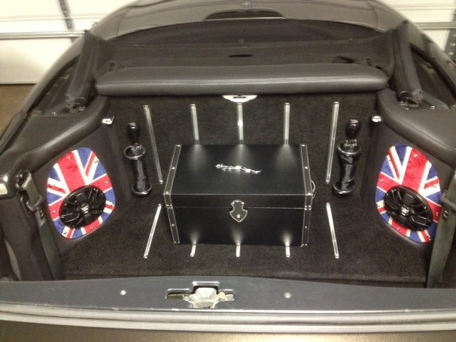

Of course I took it a bit further. Since I was in a JCNA concours show, I decided to go over the top!! Made custom umbrellas from British Autowoods shifter knobs, had to replace speaker covers so had a bit of fun, they don't really show when seats are back, and made a custom storage trunk for my show cleaning supplies.

I know. I'm in NC and I always had the question of who can fit back there. With the stupid seats, I always worried I would rip or damage them. Now it's a proper stow area just like the XKE had.
