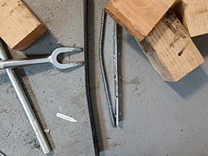

yeah at this point I can't support the hub too much (as seen on my pics in previous post) with the e-brake shoes still on...however I don't think I can remove the ebrake shoes with the hub still blocking a lot of the clips and bolt behind it.
At this point I am thinking of just getting a 20th Harbor Freight press but I wasn't sure how to decouple the e-brake wire...I took of the c-clips, the Y hardware...so at this point the e-brake wires are very loose but I can't seem to figure out the best way to de-couple the e-brake wires(see pic)

I am soaking it with Pb Blaster now and hope to hammer it out again...the funny thing is I found that the bearings themselves looks loose inside.

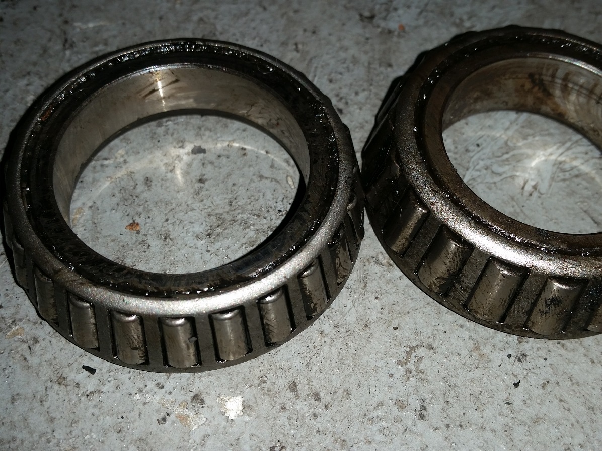

HI Zidjan,
I'm not surprised that your bearings seem loose within the carrier. When I did my first hub, the whole thing just fell apart all over the floor after I removed it from the car. Even if I hadn't planned to replace it with a rebuilt assembly, I would not have attempted to replace those bearings for fear of them not seating tightly enough in the carrier.

I saw your posts but I still can't picture how it would work...
So you use a threaded bolt with the nut at each end....how do you insert that in between the hub and carrrier? and wouldn't the gap can't be longer than the length of the bolt??
Edit: ooh was the idea is to create a jack within that hub?
Edit: I just looked at Chilly's pic again..Looks like a trip to Home Depot and some construction work is warranted.
Thanks all for the ideas... I am going to try them one by one...
I will try to make a video on the other side because I believe all Jaguarian will benefit from this
In that first photograph, there's a Torx socket. Replace that with a length of threaded rod EXACTLY the correct length to fit that gap. Try to do one on each side - pretty much opposite each other.
Then - put two nuts on each bit of rod somewhere in the middle.
With a spanner, unwind the nuts so they start to go over the end of the rod.
That will exert a considerable force which, in my case, got things moving.
You will probably have to grip the centre of the rod with a "mole wrench" (clamp wrench) to prevent it turning with the nut.
Obviously, you can only get it to move the length of the two nuts on that first try, but if you wind the nuts back, use a couple more as spacers in the gap you just created, then go for it once again, it should work.
Yes - you are using the rod as a sort of "jack" to push the hub and the hub-carrier away from each other.

Hey Guys,
Just want to update my experience. I finally was able to get the hub out and the loose bearings also fell down the floor....so since I wasn't able to see it while they're was attached, I can't be sure what goes first and last and what do I need to watch out for.
Also instead of c clip mine comes with this rubber like seal...which I partially destroyed...do you think this is usable? or order a new one?
In you first photograph, you have half of each of the two bearings, plus the large spacer and the small spacer. This is important as it sets the endfloat for the hub assembly. There's a post from one of the "proper" Jaguar technical gurus that states that as long as the same spacer is replaced in the same hub/hub carrier assembly, the endfloat will remain correct. No problem if you're just doing one side, but if you're doing both sides, keep the bits for each side together and don't mix them up.
If you get a new rear bearing kit (Jaguar JLM1708) - you will get new rubber seals.
But - you now have to get the other half of each bearing out of the hub carrier.
If you look inside the hub carrier, you'll see a slot on each side wide enough to get a punch or drift against the back of the outer bearing. A few sharp hits and they will come out fairly easily.
The two bearings are slightly different sizes so you can't mix them up.
Cut a slot in the outer part of each of the old ones, and use this to push in the NEW outer part. (a length of threaded rod and some big metal plates will help here).
(The slot is so it doesn't get jammed in there which is what you DON'T want to happen !!)
Then - the order is rubber seal, bearing, big spacer, small spacer, second bearing, second seal.
