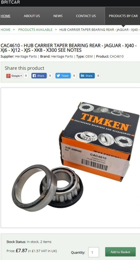

Looking to source some bearings for lower rear wish bone or control arm, what ever you call it. Can’t seem to find much online. Part number is cac4610. These are for the fulcrum bolt, not axle bearings. Let me know if you have a source. Thanks

There are plenty available in UK !!
Try Britcar
https://britcar.com/product.php/1095...x300_see_notes

Make sure that you put some witness marks on the pivot bolt before dismantling, so that you maintain rear toe on reassembly.There should be an arrow embossed on the bolt head flange to help with this?
Have a read through this thread as it will show you what you will encounter, and contains a link to a JTIS document:
https://www.jaguarforums.com/forum/x...2/#post1771483
SNG Barratt US lists them but they're pricy compared to what PKWise has linked above...
