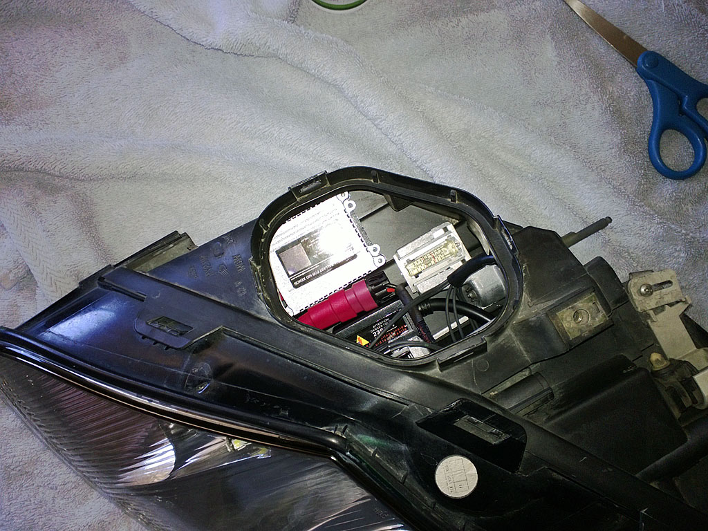

So I've finally done it. The Xenons are in, and I could not be happier .
I chose to go with
35W, 6000K kit from Kensun (available on Amazon) 35W, 6000K kit from Kensun (available on Amazon)
after reading through old threads and per recommendations made by seasoned members of this community.
Per XKRacer's suggestions in many other threads I also opted for full enclosed headlight install (ballast and adapter) for cleaner look. However, I could not or rather did not take enough time to figure out how to remove the dip beam assembly to slip the stock wiring by and chopped it off instead. I also needed longer wires to neatly arrange the components so it all paid off at the end.
Took me about 2hrs for both lights to accomplish with rewiring...First light took longer than second as I was testing the waters with component placement etc.
Below are some for naysayers showing my 1999 XK8 stock beam next to the new Xenon setup.
Also have a picture of the arrangement within my headlight...and yes, I am still able to move all other bulbs around .
To sum it all up, thinks are disproportionately brighter now...
Below is a "messy" guide that I've compiled from pics I photographed during my kit fitment . Hope it'll help to inspire other drivers!
Xenon_HID_Kit_Fitment_Guide_XK8.pdf
