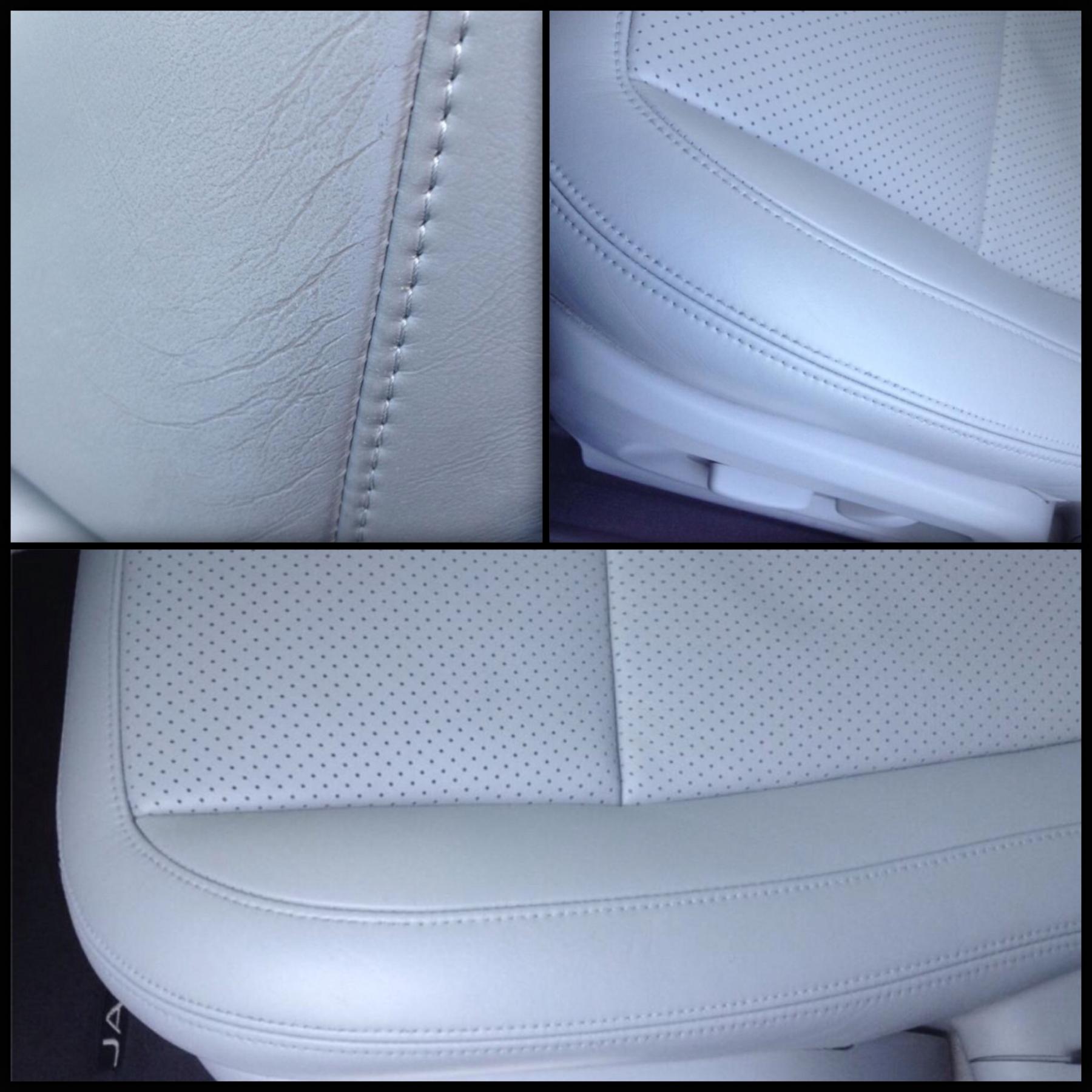

Seat Before
Bolster Before
Seat After
Bolster After
Project this last weekend came out perfectly. It may not look brand new but the seats look infinitely better; have become supple again; and have that smell of "rich English leather". Not bad for 17 year old seats!

Had to color wash it 4 times and then airbrushed it

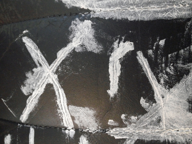

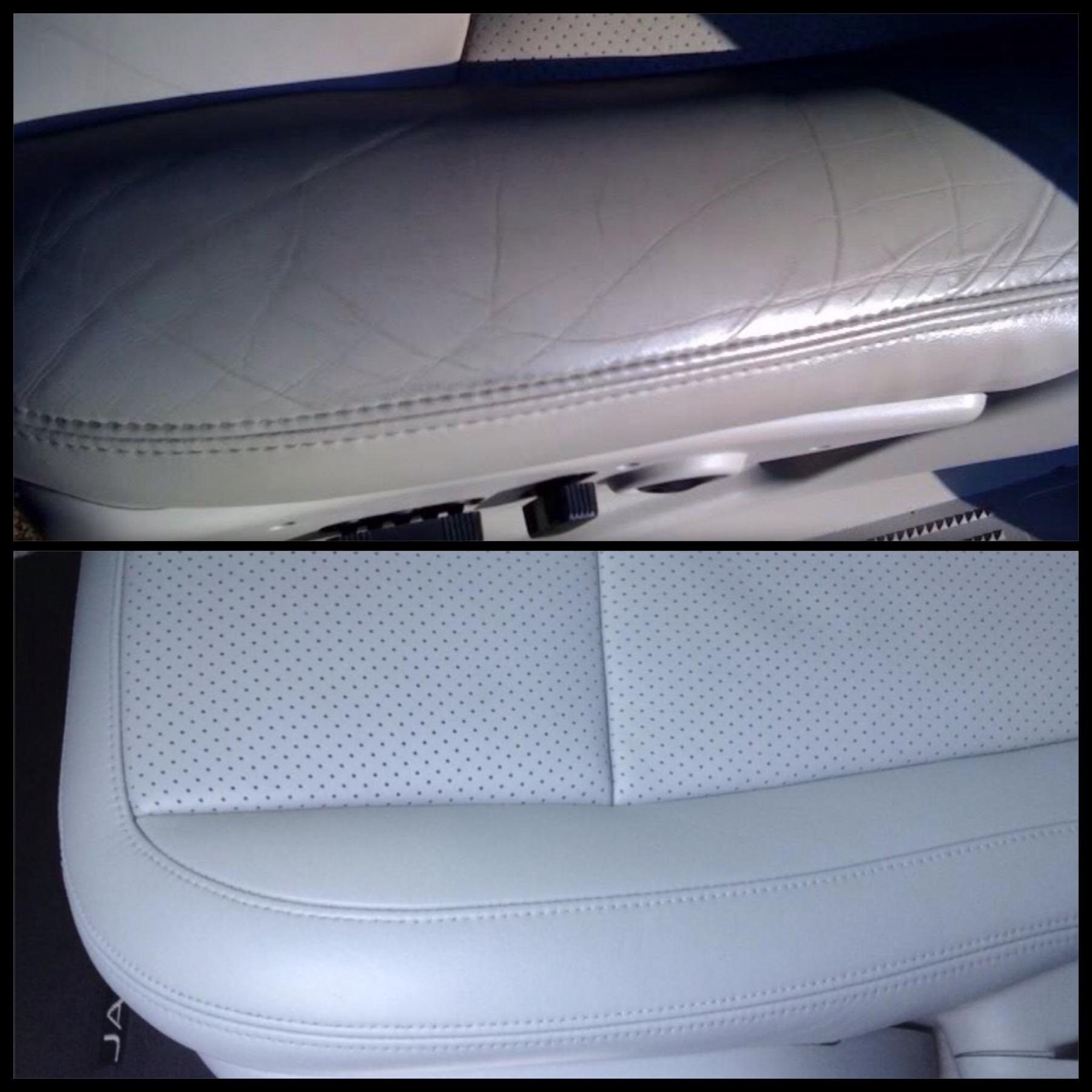

Originally Posted by JonWat
How about some pictures?
Here's a few pics. Now, my seats were no where as worn as OP's, which I agree look much better! (Although I think with his new found confidence in refinishing, he should order a crack fill kit and really upgrade his repair! No doubt he can do a great job!)
The cracked bolster pic on my XF were much worse and also on the seat bottom. Unfortunately I didn't think to take totally before pictures. The bolster pic was taken after first cleaning. But before I started sanding them down. The seat pics show the after. And no evidence of the two cuts I repaired.
This is a very tough refinish product. My dog has jumped on it, and I drive it every day and still looks brand new.
It's 59.00 a can and comes with special cleaner and a scuff pad. But I used 2000 grit sand paper and sanded down the creases and deeper cracks until they were almost invisible. This is nothing like the Duplicolor vinyl and fabric spray.
The seller says they can match most interior code colors, even on older cars.
