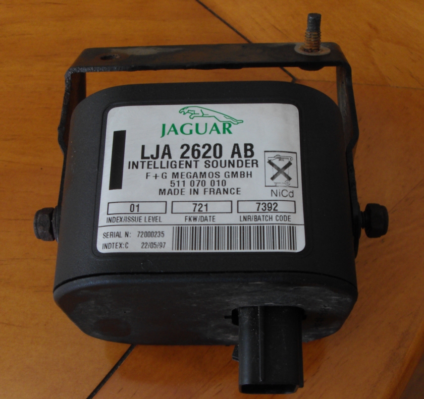

Both intelligent and passive sounders look like this :
Remote lock/unlock confirmation question-alarm-sounder-1.jpg
and the plug is the same for both - the wiring is different.
