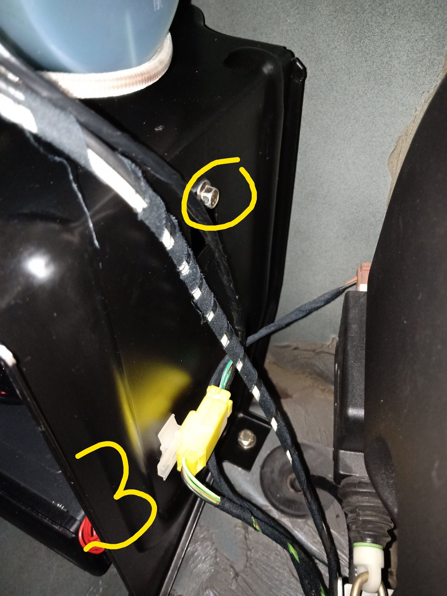

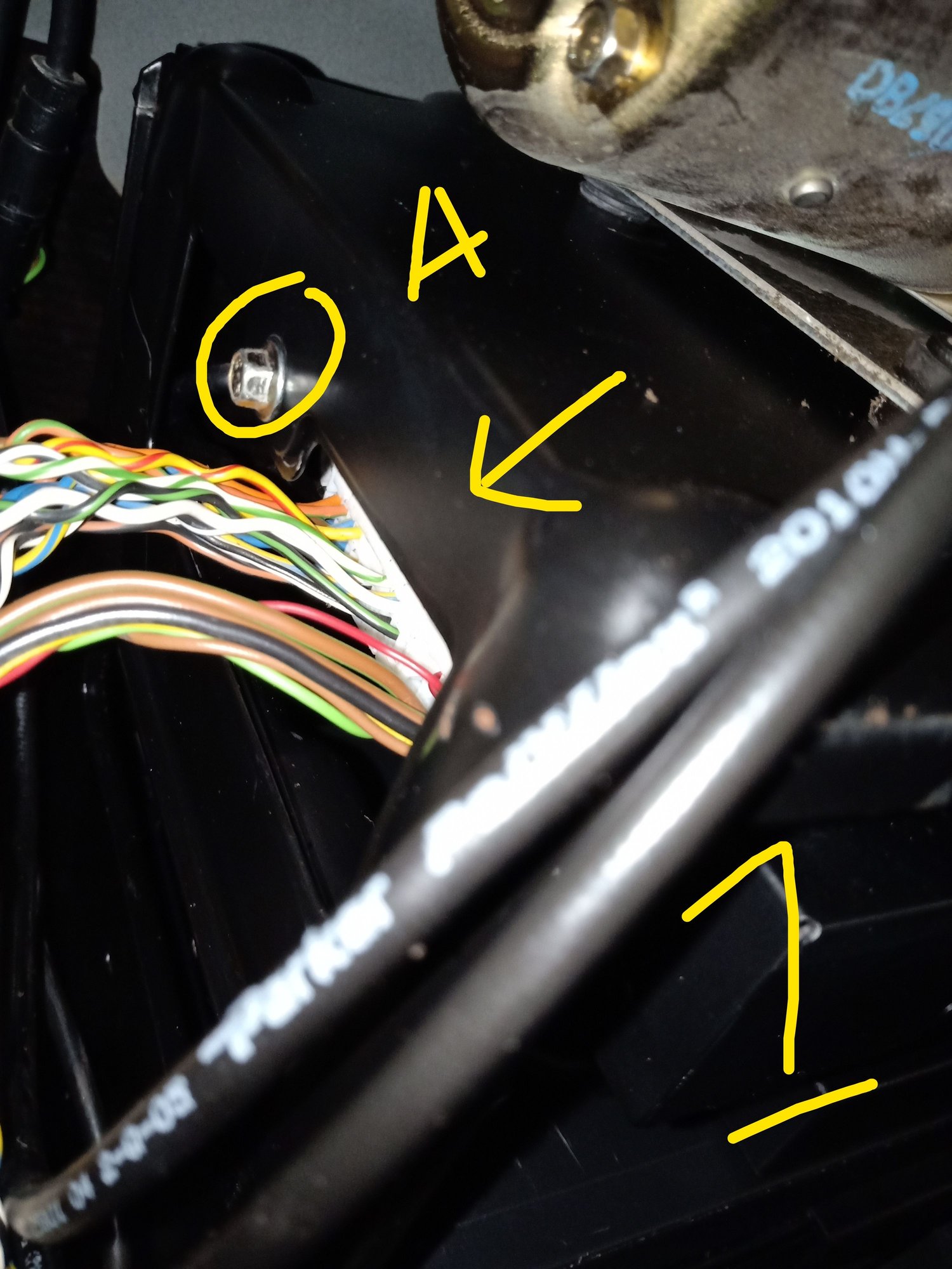

  • Remove the cables from the amp from the side (2 wiring harness and 1 cable (from dvd navi) see pic 1 (arrow)
  • Remove the 2 bolts on top of the bracket. See pic 2
  • Remove 2 bolts at each side of the bracket. See pic 3 and pic 1A
Then you can slide out the whole assembly.After that it is pretty easy. First remove the amp (4 bolts) and than remove the side brackets from the DVD and CD player.
