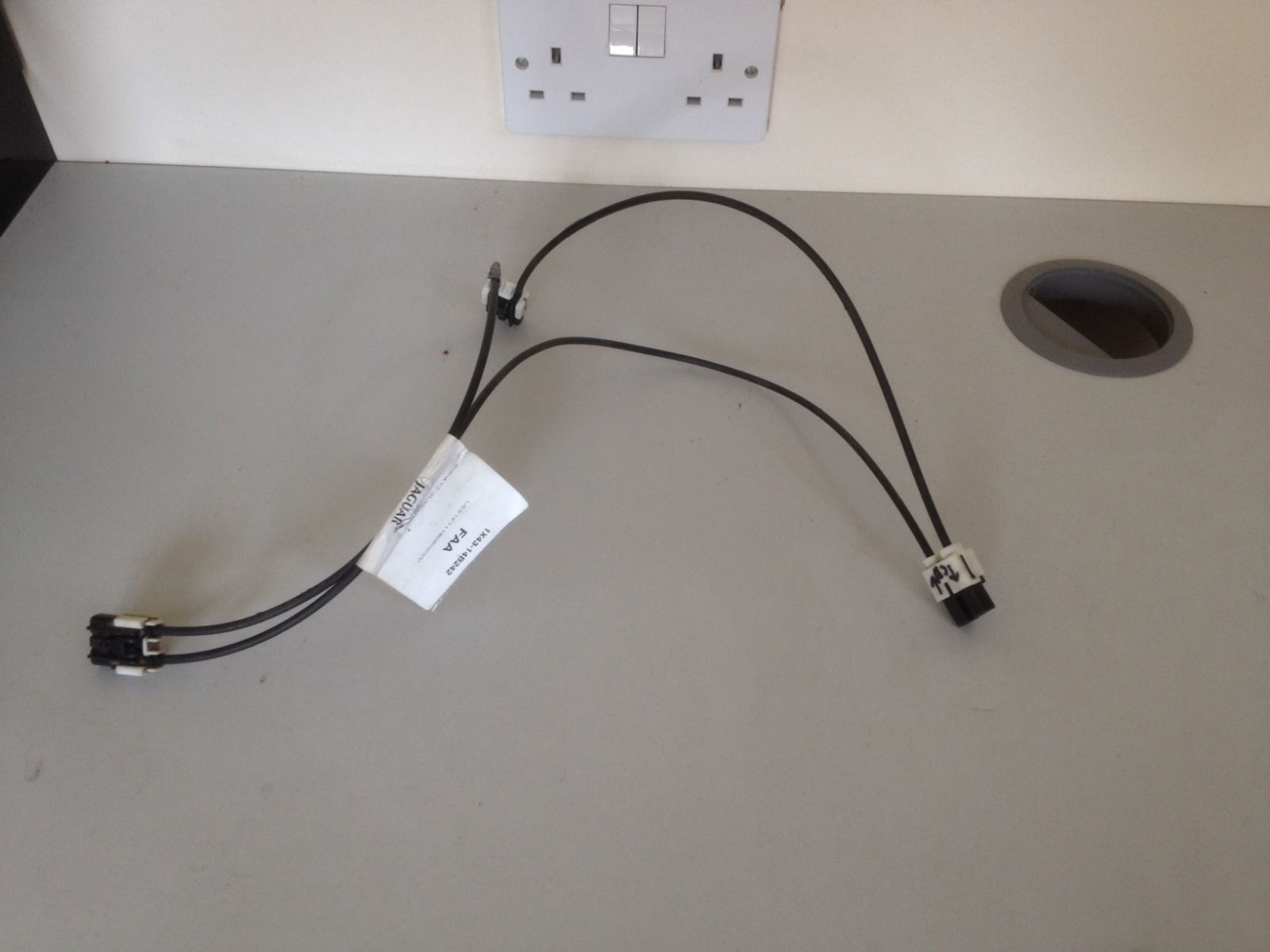

Thanks Barry W...I've just purchased the cable and hope it's the right one. Can you confirm it is and if not a link to the correct cable I should get? Cheers

That's the one, now........the 2 wire fire optic cables comes in from the side of the car, one of the two fibre optic cables " flows" in.the other " flows" out ...so you have to organise the Fibre Optic cable so that the first connection is to the CDC then to SAT Nav as in a daisy chain..
Hope this makes sense.........I'm sure this must have been covered before as this is a common upgrade. ( by someone more eloquent than me!)
B

Bucky,
I've just checked again.
the daisy chain Fibre Optic should run..........
cabin ( from the car) to CDC to Phone to Voice to NAV to AMP back to cabin.
Ok, assuming you don't have all the other bits and pieces.yours will be as follows
Cabin ( from the car ) to CDC then daisy chain to Nav then back to cabin...
Just remember, you'll have to go into the Touch Screen options, so the system will recognise the additional CDC.
B
