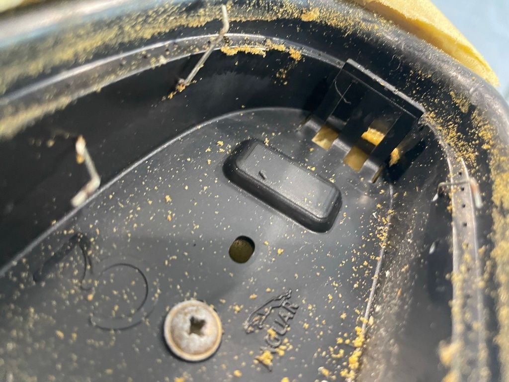

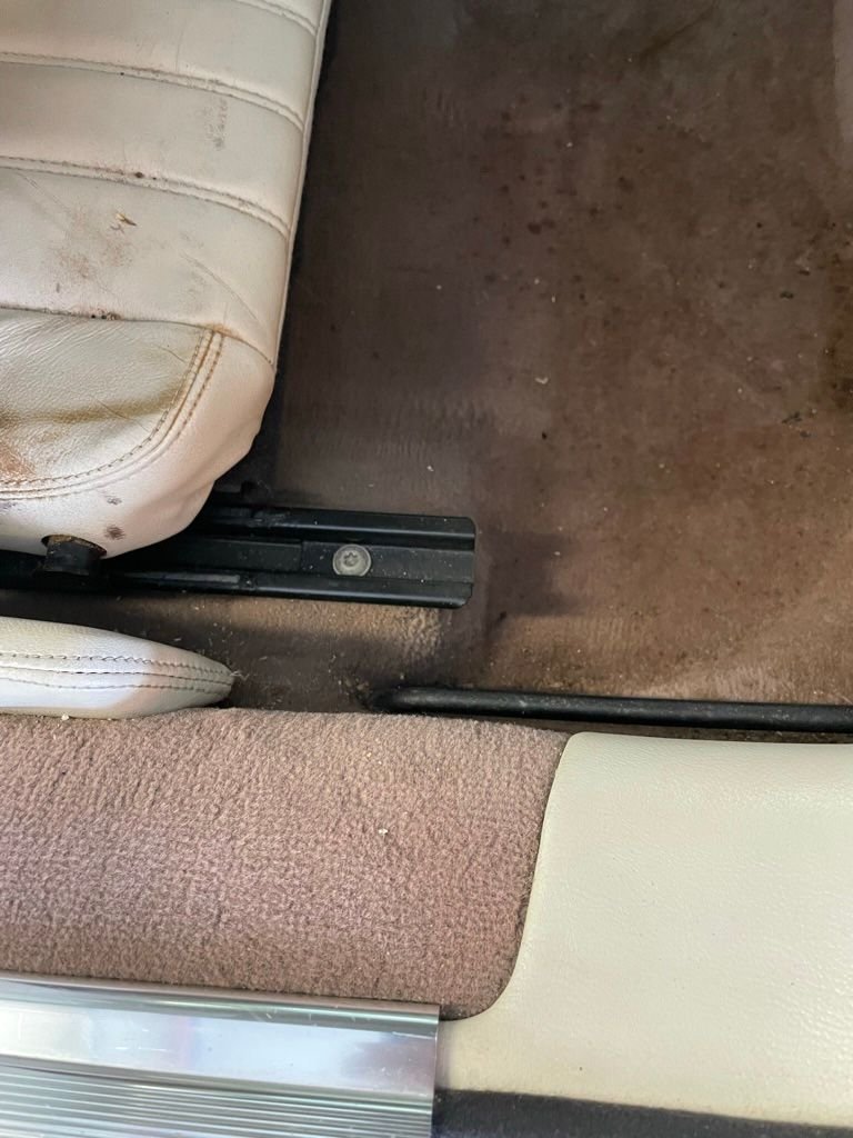

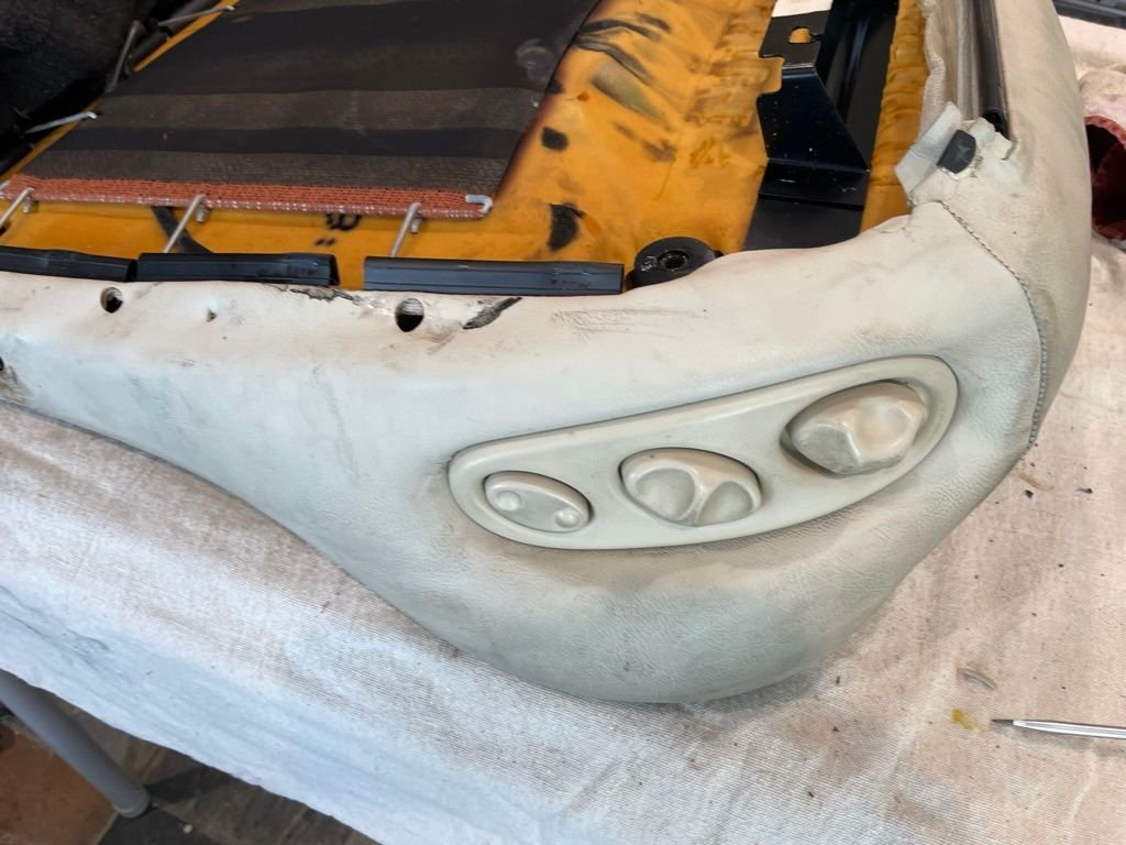

Hello Pistnbroke,
Is this the piece you are referring to in your post? “switch panel” 3rdt picture
If so, here is how it is held in place. 2nd picture
Be careful removing the switch because it is easy to snap the clip style retainer.
However, this has no relationship to securing the seat to the floor. The seat is secured by 4 bolts that can be removed by adjusting the seat back and forth to the stops. 1st picture
Hope this helps.
