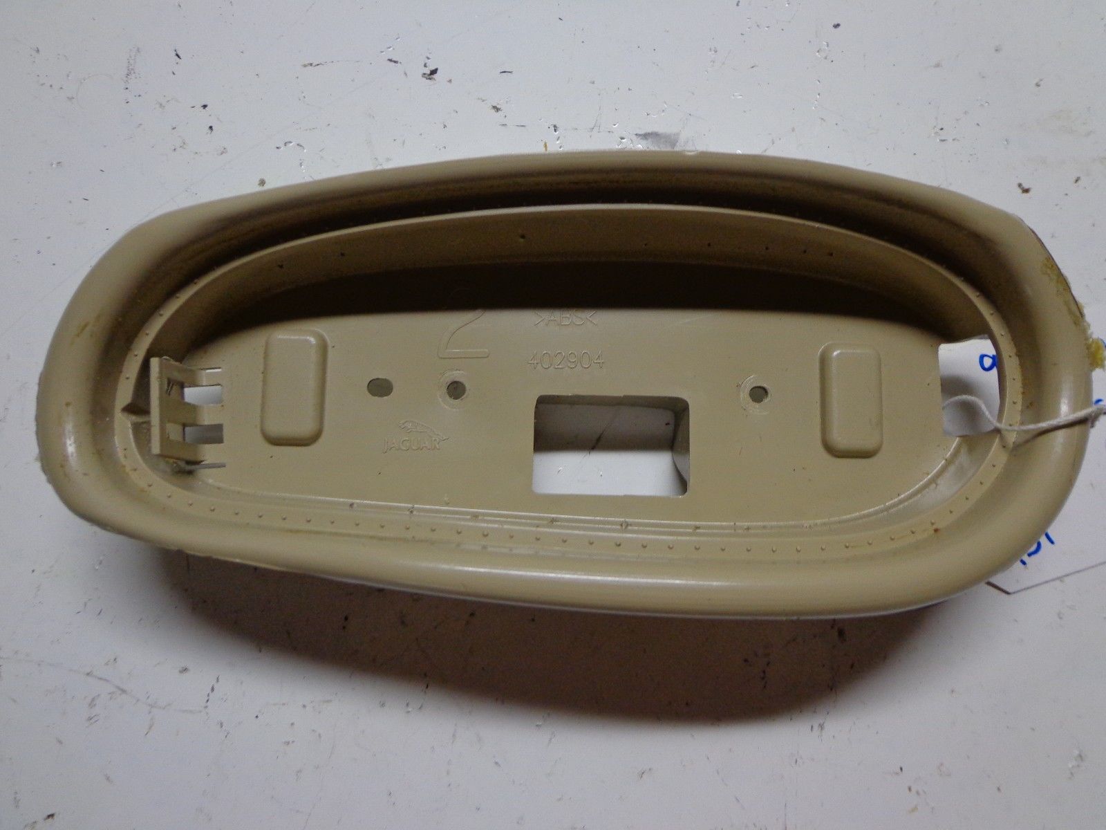

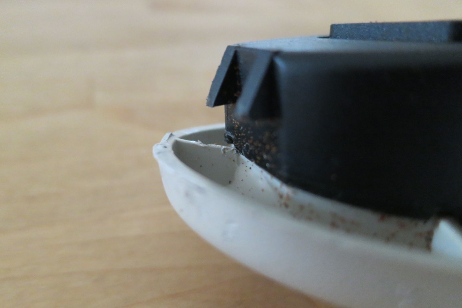

I am going to have my seats recovered next week. I have read that you have to be careful removing the seat switches, so I thought I would do it myself rather than the trimmer. I have read JTIS on removing the switches. My question is where is the tab you need to depress. The switch pack seems to sit in a plastic case that seems to be screwed to the metal frame. I see no tabs to push. Do you get to it from the edge of the switch cover or is there a slot you stick the screw driver in? Is it on the side or the bottom? I am lost. I am trying not to break the damn thing, but all I can see to do is to pry the thing out. Please help.

After doing more research, I found some old pictures on ebay and figured. The tab is on the back rear of the switches, opposite side of the switches. You pry the tab back and the switches fall right out. see phoyos
