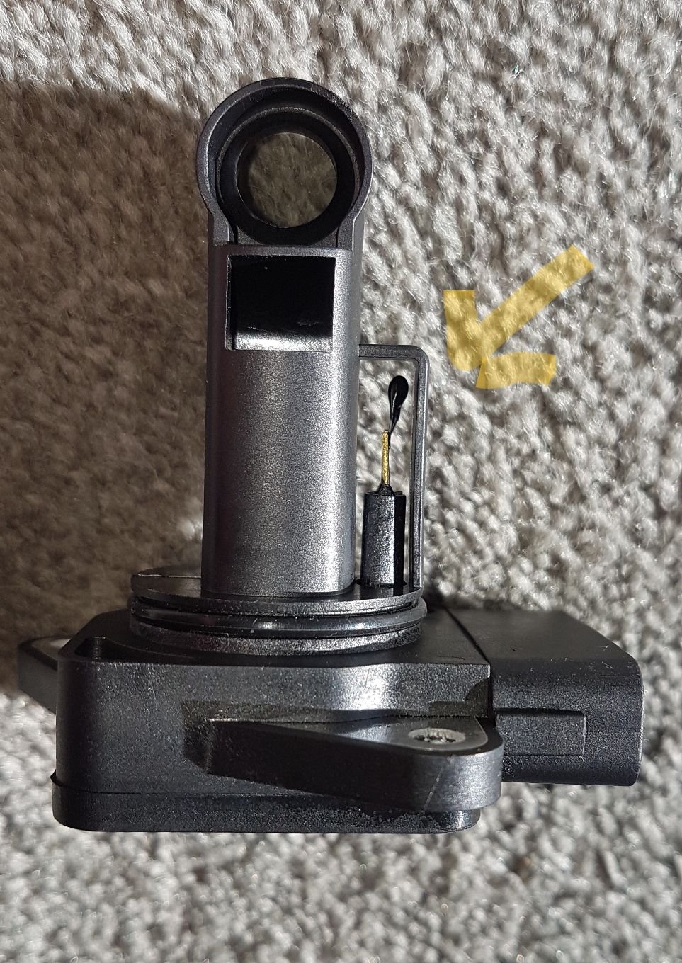

I put the original Denso MAF back in. The car certainly seems much more response with the new Delphi MAF - BUT, it idled perfectly with the factory original Denso in it.
I might still try resetting everything with the new MAF but I think it's a bit of a long shot. What are the odds of getting RockAuto to refund me for the one that they listed on their website as being suitable but doesn't idle?
Another long shot. I noticed the dangly hanging down bit on the new MAF was not centered (vertically) in its enclosure - see pic.
It is centered on the old Denso. Could that make a difference?

First off thats NOT the MAF sensor. I made the same mistake. Have a read Click Me To Read
The other thing depends on where you are in the world. If your in the UK then your in luck https://www.gov.uk/online-and-distan...for-businesses. You have 14 days to return it, hope you kept the packaging, though its not strictly necessary.
One last thing that sensor does not look right at all. Compare it to mine in the link above. You could also use this as a reason for returning it? Send him my photo and yours. I hope the MAF was over £42 as that is the lower limit.
This is the intake air temp sensor. The value is available over OBDII. Check if there is a correlation with reality. Should be outside air temp, plus a few degrees at idle, closer to outside air temp as you get some speed.
PS: As pointed out before, make double sure the o-ring at the base of the sensor is there, and is a good fit/seal. You can even try and swap this o-ring with the old one to check for a difference. A missing o-ring there has been reported as messing up the reading a lot more than it would seem. Remember, this sensor samples the air flow, so any changes to the flow of air to it could mess up the logic (K&N filter?). Last, you really need to read these fuel trims. Maybe the old sensor put them way out of whack, and this new correct sensor is just waiting for the trims to adjust.
Thanks for this. Will disconnecting the negative battery lead overnight reset the fuel trims? If not can it be done without diagnostic tool? If I can reset the trims I'd like to try that with the new MAF.
At the end of this at least we'll know one way or another whether these non oem MAFS will actually work with our cars...
